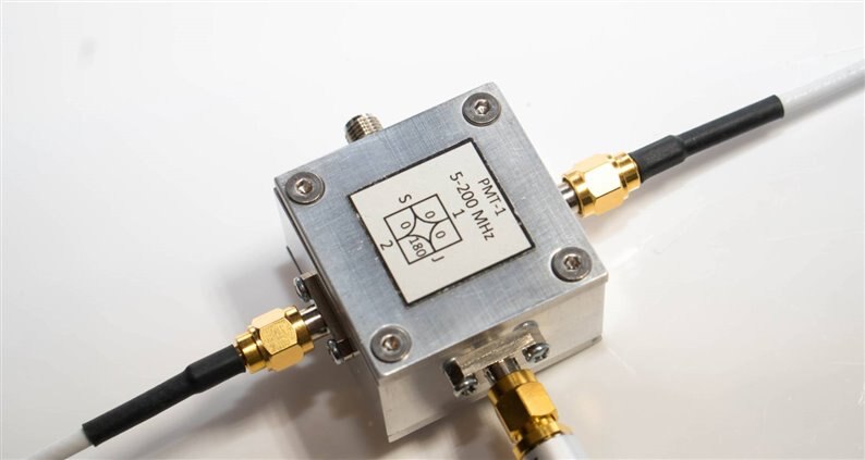

From the previous blog post, it is clear that these differential probes will offer a 1 kohm (450 + 50 + 50 + 450 ohm) resistance to the circuit under test. The connectors on the right need to be combined into a single output. To do that, a combiner/splitter type device can be used, also known as a hybrid coupler. They look like this:
There are four connections on it. This one happens to use SMA connectors. The four connections are labelled 1, 2, S and J. The ports 1 and 2 can be used as inputs, and would be connected to the differential probes. The S port and J ports are both outputs. The S port provides the sum of the two signals with zero degrees phase shift. The J port provides the sum with 180 degrees phase shift (there are 90 degree versions too, but that is not used here).
The S port needs to be terminated in a 50 ohm load for this use-case, and the J port is attached to a spectrum analyzer (observe precautions like suitable attenuation and DC blocking if required - the low voltage tests in this blog post did not require that).

As mentioned earlier, it is good to take precautions such as inserting an attenuator and DC block if there is any risk of damaging the spectrum analyzer. The photo below shows how the connections were made. The 50 ohm load here is overkill, only a tiny screw-on load is needed. For the combiner/splitter,I used what I had which was a Minicircuits PMT-1+ device (5-200 MHz response), inserted into a metal case. The one that Jon mentioned was a ZFSCJ-2-1 device for 1-500 MHz response. I will probably purchase this one eventually: PSCJ-2-1+ for 1-200 MHz response (it's a bit lower cost).
