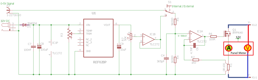

First up the schematic
Adhering to the classic, It contains a 5V reference IC and a Dual Op-Amp, most of the schematic should be readily identifiable but I will point out a few things. The DC load will also handle input from an Arbitrary Waveform Generator (0-5V representing 0-5A) and up to about a 2 - 3 KHz square wave if you so desire. It also has a transient response time better than 100uS.
C4 (365pf) and C6 (4.7nF) are required to minimize or prevent oscillations in the control and believe me it will oscillate without C6 and quite badly, see the videos below regarding this
Here is the initial post Electronic DC Load - Design and Build to test PSU Project and a performance tuning video here:- Electronic DC Load - Performance Improvements
The schematics in those posts contained a slight error in the trimmer connection for the VREF, I had it between the supplies rather than the output and Gnd. The above schematic has this corrected.
The values of R4 and R5 are dependent on how accurate you want this to be with respect to a known input or the output of the 5V VREF. The more accurate or more correctly stated, the closer they are to a 10:1 ratio the more closely the DC load will track 0-5V to a 0-5A load.

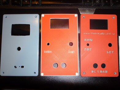

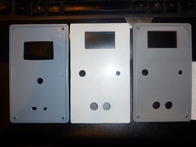

For housing he project I chose a basic grey project box and after "Hacking" the lid and being completely disgusted with the result and decided to 3D printed one
Here is my manual attempt next to my 3D printed versions, the middle version had no ribs on the back to support the walls of the main case and was also a tad thick so I modified it further to be more like the original and as you can see, asside from the text being too small or with a few small details that did not print correctly, it seemed to come out pretty good. I am still having difficulties with my printer but I can get some good prints out of it, btw, all of the holes came out exactly the correct sizes to no adjustments where needed. I will attached the design files for this so you can have a look and use for your own projects if you so desire.
In order to get good measurements from the original (and I would suggest one of these to anyone doing 3D design), I used a Digital Engineering Caliper, this made getting the right and accurate measurements easy and quick
You dont have to use an Electronic one, I just found it easier

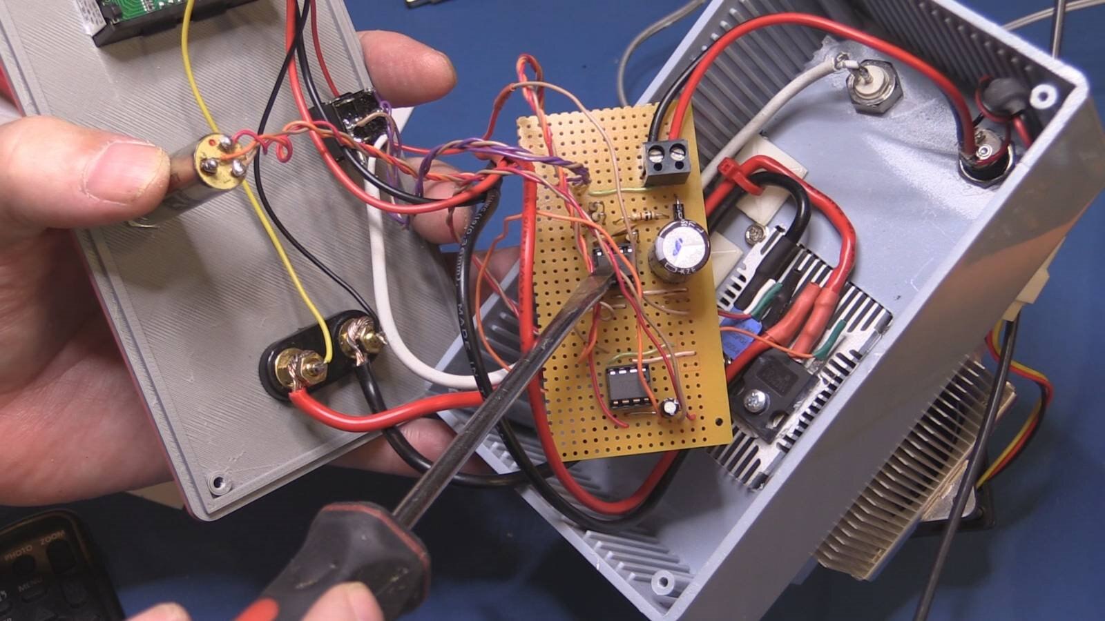

below is an internal view of the build unit, as you can see, this is a one off so I simply used strip board and most components I had lying around. The heatsink if your wondering is from an old pc, it was the CPU Heatsink and has a fan already mounted on it. I was supprised how well it dissipated the heat from the FET. I guess it should when you consider older CPUs could easily require 150W of heat dissipation, I simply used existing holes to mount it to the plastic case and drilled and tapped holes to attach the FET and Current Sense Resistor (I did use a 100mOhm 1% Vishay Kelvin connection resistor for the current sense though image )

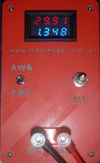

The connection top left is the input from an AWG or other 0 - 5V source, on the rear right is the 12V input jack, on the front panel you can clearly see the binding posts, the 10Turn pot (It is a bad fit as it is too long so I have others on order to replace it, they are not here though in time for this posting.The switch is in line with the pot and is used to select the POT output or the AWG input. I did not terminate the external input, I thought about putting a 50 Ohm resistor there, then decided it would be better to not have it inside and leave it to the user to add one external if needed, I also did not have another trim resistor of the correct value in a 10 turn type so it is also not yet installed, but as this does not need to be super accurate, it works just fine without it.
As i said, his DC load will handle plenty of power, I have already left it for several hours with 30V and 1.5Amps so 45 Watts, and it was barely above ambient and have also loaded with 60V at 1.5Amps with no ill effects so I have confidence it will perform for most of my desired uses and my next one will be far more capapable anyway.
Here is the video of the final build and testing
here is a snap of the response time with a 2Khz sqare wave input, measured across a 1Ohm load so this shows a very good response with a 1Amp step in load
The display I have included provides 4 digits of remarkably accurate readings for voltage and current, I di hack it to allow the current sense to work in differential mode as initially the low side of the current sense resistor was tied to the oV of the panel supply, not sure whay but after removing this connection, the meter worked better in my solution
here is the schematic with the meter in place (Note the trimmer connections for the VREF are not correct in this drawing, refer to the one above for the corrections). this is just to show how the DPM is connected into the circuit, as the DPM current shunt is only 25mOhms, it has no noteable effect on the operation or the uniit under test.

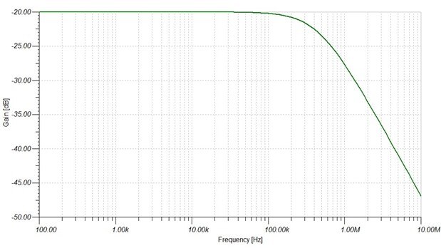

    This is the input filter
    and here's the response - you can see it's flat up to about 100kHz and then rolls off.

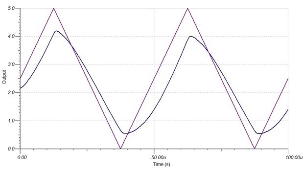

    This is the effect it has on a 20kHz triangular waveform. It reduces the high-frequency content, which is mainly at the top and bottom with the sharp change in direction.

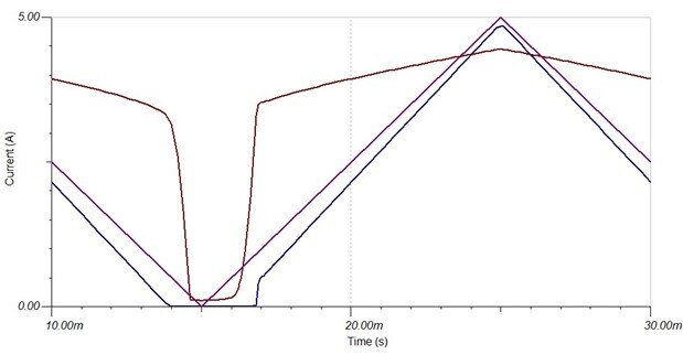

    If we look at what the whole control loop does with the same waveform
    then it looks like this (purple is the input 0-5V, blue is the output 0-5A)
    Basically, you could increase the input capacitor a great deal before you even get down anywhere close to affecting the waveform in the way the output loop response does. The capacitor is keeping high-frequency noise down and slows down fast edges (so it is doing something useful), but it's the 4.7n (and the FET capacitances and the op-amp's internal compensation) that largely defines the overall response and whether the whole thing will be stable. (The 4.7n was presumably chosen to be large enough to dominate the smaller effects.)
    If you want it as a DC load, you don't need to worry at all. If you're happy with it as a DC load that can take a waveform and be adjusted to give something like the current waveform you want, then again you don't need to worry. If what you want is a precision active load that will accurately follow a waveform, then you'd want to look at it more carefully, but you'd do that as part of reworking the whole output stage.
    In case you are interested, here are the waveforms with a 50Hz triangular wave. The step at the bottom end of the current waveform comes from the output of the op-amp drifting down when the output is off and then not being able to quickly get back to the voltage necessary to control the FET. (Purple is input 0-5V, blue is output 0-5A, and the brown trace is the gate voltage.)
    Don't take this as being in any way criticism of Peter. He presents the circuit as a DC load which you can, if you want to, control with a waveform. For many purposes the circuit is absolutely fine - it's simple to build and quite good enough (particularly if your alternative is a light bulb).
