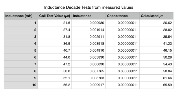

The first picture shows the open circuit output voltage of the coil test function measured through a 500x differential probe. You can see the output gets up over 1 kV with a rapid rise, that the scope could not measure and then drops away over 100 us, but never appears to go back down to zero.
I set up a number of tests using the 40 and 100 turn coils I had wound for the current amplifier to provide a load. These have been measured as having 19 uH and 135 uH inductance when tested. They read 11.12 us and 27.37 us respectively when tested with the MetraHit coil test. Interestingly, with the two coils wired in series, the MetraHit read 29.5 us, which is less that the sum of the individual tests. With the coil test having a load, the currents were measured with a Flux Flex clamp wired to the scope and the Flir CM55 set to inrush mode.
This did not work to well, so to build up the inductance, I utilised the spare coils of wire I had from winding the coils and linked them together. The table below shows the measurements and the coil test results. You can see as the number of coils in the circuit it increased, the coil test value also increases. I still did not have enough wire to reach the limit of the coil test function.
I captured the voltage and current for some of the tests. Below are the plots for 1 coil and then 4 coils under test.

It can be seen that as the inductance is increased, the current supplied during the test drops, the individual pulses are also seen to expand, but the length of the pulses did not correlate with the coil test value produced on the MetraHit. A video of some of the coil tests carried out.

    I have always been told to measure values of inductance above around 1mH with a lower frequency of 1kHz and then reduce the frequency further as the inductance in increased to get the best accuracy.
    I did use an inductance decade to test the MetraHit coil with but got quite bad correlation, that only got worse as the inductance was increased. There is a snippet of the data collected below, even playing about with a different capacitor value I could not get correlation between actual measured us and calculated us.
    I suspect that the physical size of the coil may also be coming in to play with tests on the MetraHit, with the motors being much larger and the pulsing nature of the instrument, there is more interaction with back emf.

    I don't think you are that far out Shabaz. The calculations for open air coils seem to tally rather too well.
    Going back to metal affecting the motor coils, the stator windings will be embedded into the laminated stator core, that will affect the inductance value. The coils will also be wound in close proximity to one another over a larger surface area than the coils I tested in the air. This may be affecting the results.
    At the moment, the coil adapter is just a black box, so I do not know exactly what is within it. I can also get an inductance reading on the input of about 4.5 H along with a resistance of 0.20 Ohms. The output I do not get any inductance reading and a resistance reading of 0.56 MOhms.
    I will probably give them until the weekend to respond and if they don't I may consider my options to open up the coil adapter.
    I have been back through the manual and the meter operation and I am not aware of any settings for the coil adapter within the menus. The coil test is on the same rotary switch selection as the insulation test, but is then activated by a different control button.
    I presume that if you get a different adapter, all it does is all the reading back under the 250 us limit of the instrument as the test is only a balance measurement across all three phases and not a specific value defined by the motor.
