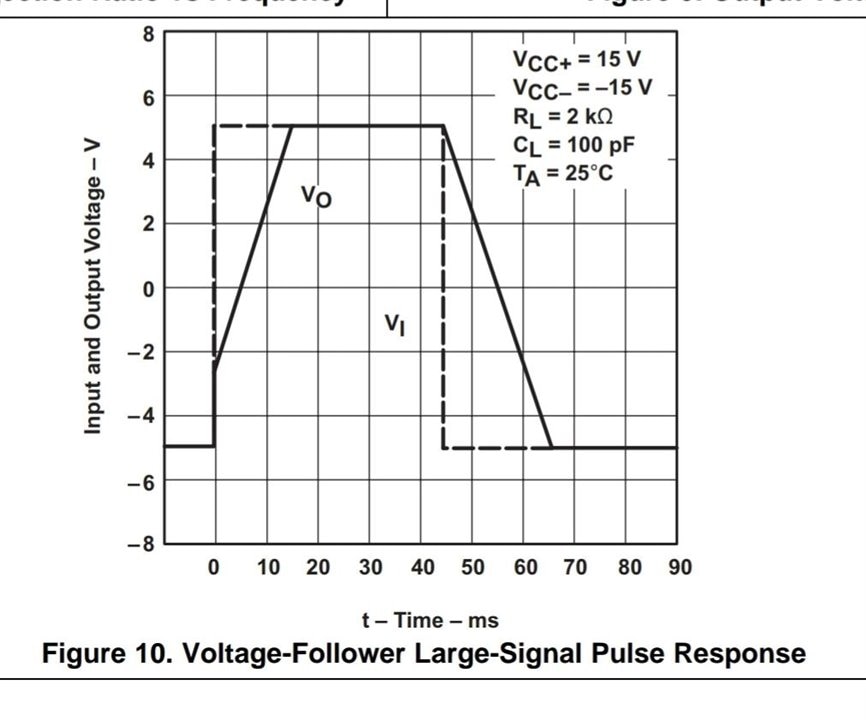

    "it immediately goes to the rail voltage"
    not with a 741 it doesn't. The slew rate is less than a volt per microsecond, and that's slower than the recommended input transition rate even for a slow logic like HCT. In practice it would probably happily work anyway (for a personal project), but there's a danger the input might oscillate during the transition.
    Jan Cumps over 1 year ago in reply to jc2048
    Yes, it's too slow for real world applications:

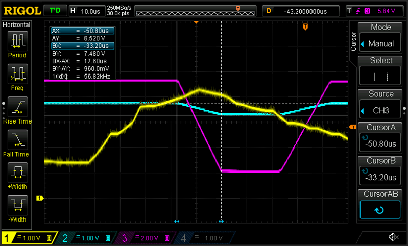

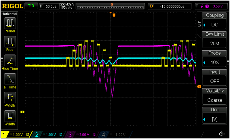

    change of plan. I set up the circuit with the 741 anyway . My last LM324 is defect.

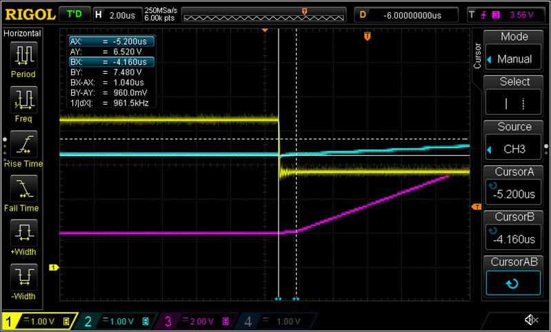

    1: Falling edge
    2: Rising edge

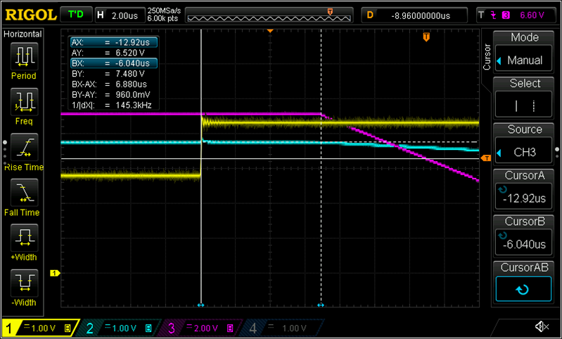

    3: recovery from negative rail: I didn't find a good way to do that (edit: see next comment below). Looks like it doesn't struggle with that. Most likely either my technique or understanding is off:

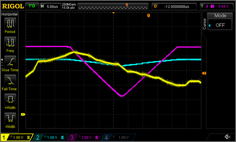

    4: it definitely looses the plot with fast cross-overs. This signal spans the hysteresis at each edge:

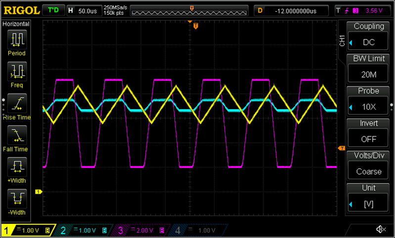

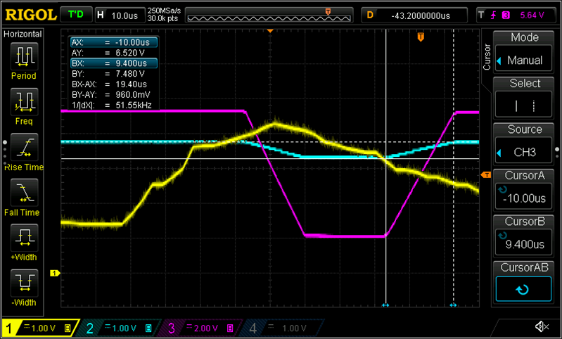

    5: maximum frequency where a triangle is correctly processed: around 10 kHz
    I tried to place that triangle so that it results in a 50% duty cycle. Faster than that, and there's no flat area in the output left. At 23 - 24 kHz it loses the tracking completely.
    Jan Cumps over 1 year ago in reply to Jan Cumps
     jc2048 is this the recovery you are referring to?
    Negative rail:
    Positive rail:
    shabaz over 1 year ago in reply to Jan Cumps
    1. Very useful. I would not have been able to predict the output that you got for point 4, but now it makes sense. How did you generate that chopped input signal like that? Custom or the AWG contains it by default?

  • jc2048
    jc2048 over 1 year ago in reply to shabaz
    "Very useful. I would not have been able to predict the output that you got for point 4, but now it makes sense. How did you generate that chopped input signal like that? Custom or the AWG contains it by default?"
    That one confused me too initially, until I realised that Jan was showing us that the compensation in the 741 is effectively an integrator.
