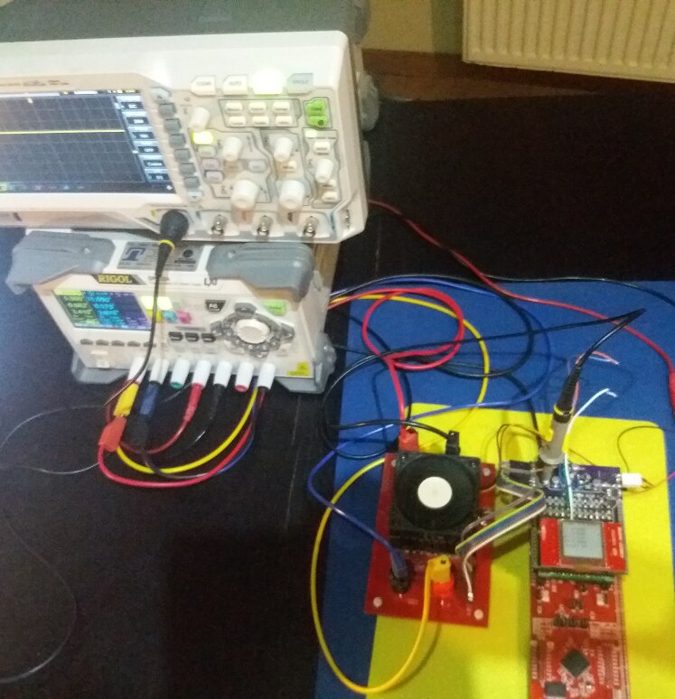

The best option I have is a Rigol DS1054Z oscilloscope. It offers four extra voltage probes (channel 1 - 4) with reasonable precision.
Good enough to get a view on the instrument's internals.
This blog shows how I included the oscilloscope in the already existing test setup, as an optional instrument.

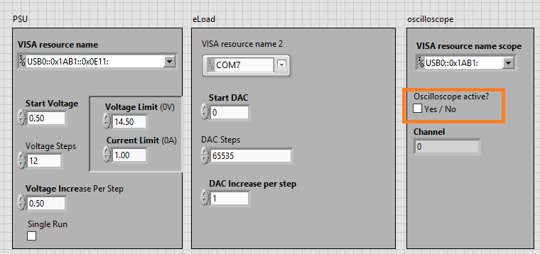

I don't want to use the scope each time I want to measure the efficiency of a device. The base setup should be easy to set up.
That's why the process can run with or without the scope included. A switch on the start page determines if the flow looks for the scope and takes measurements with it.

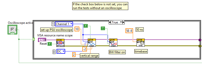

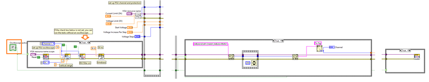

In the block diagram, you'll see that any process that uses the scope is in conditional blocks:
The results of the scope measurements are logged into a spreadsheet, next to the other measurements in the flow.
If the scope is not active, these columns exist in the file but are empty. I could alter the flow to not have these columns but didn't.
