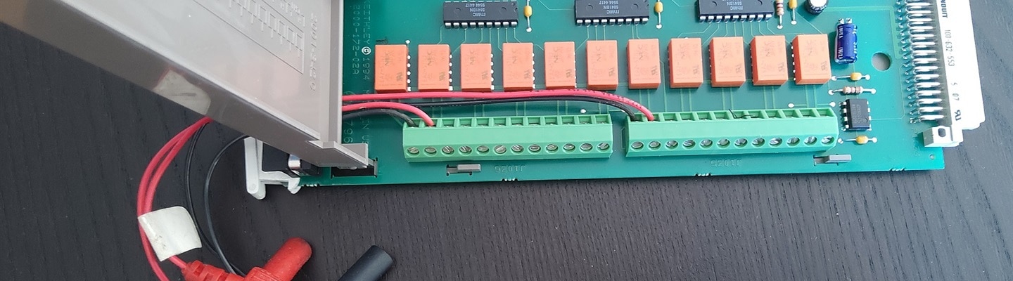

I road tested the  Keithley Bench Digital Multimeter DMM6500. I recently purchased a 2000-SCAN 10 channel scanner card. This is my fist little test after receiving it.
I bought a 2nd hand card. 250€ on eBay. It's the relay version (there's also a solid-state version).
It can switch 10 2-wire inputs. For low resistance measurements, you can make 5 4-wire measurements.
Photos
At the top of the post, you see the front side with the lid closed. Here is the same view with that lid open.
This is the unspectacular underside:
Wiring it up
I've wired channel 1 and 6 up. So that I can do 2 2-wire measurements or one 4-wire one.
Then plugged the card into the DMM dock:
I connected the 2 channels to a power supply. Channel 1 to a 1V dc output. Channel 2 to 1.5V dc.
Specs
Setting up a simple scan
I defined a DC Volt scan for both, taking 1 sample on each channel
Then I used the Channel App, and ran the scan:
Simple start, but it worked as expected.

    I'm surprised you didn't actually build one Look here: DC switching board . neuromodulator made one. I've been thinking (and procrastinating) about it too. Then this one popped up in my eBay search…
    Jan Cumps over 3 years ago in reply to Gough Lui +1
    One hesitation I would have buying second hand is simply the amount of wear on the relays. It was a gamble. That's why I never bought 2nd hand ones that were going for a higher price. 250 € is still…
    Jan Cumps over 3 years ago in reply to neuromodulator
    > It's not like it would have increased the price that much to keep the count in the board itself.
    That is true. But this is the basic card. They have ones that keep count, but they cost more.
    This one is capable but bare-bones. All logic comes from the DMM.

    The reference manual states:
    "The DMM6500 keeps an internal count of the number of times each relay has been closed. This count can help you determine when relays require replacement. Refer to the card documentation for the contact life specifications for the relays."

    I have one real goal: be able to automate analog design specification / validation / testing. In particular my own designs.
    There are secondary goals: learning, gain niche industry skills, entertainment, lab geek factor.
    And being able to see how a good company like Keithley solves an engineering problem like: how do we measure many things fast at an affordable investment.
