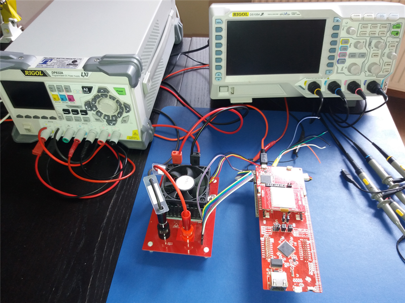

The core of the test setup is the electronic load. That's the device under test.
A programmable power supply is used as the source for the load.
A programmable oscilloscope is (not yet) used to measure some additional circuit points.
All devices are linked to my laptop via USB. The laptop runs LabVIEW to controll all devices in the setup.

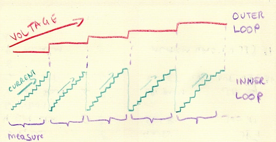

The test flow is made of two embedded loops:
  • an outer loop that sweeps the power supply through a range of voltages. It tells the PSU what output voltage it has to supply.
  • an inner loop that runs once for each outer loop step. It tells the load to sweep through a range of currents it has to pull from the supply.
In that inner loop, after giving the circuit time to stabilise  - and after giving the load the time to sample all ADCs, we retrieve measurements.

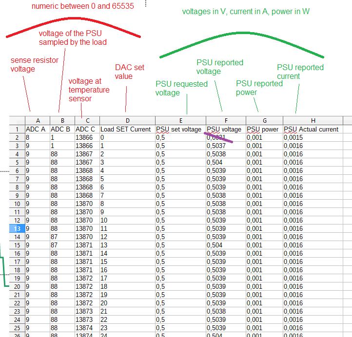

From the load, we retrieve (all in pure ADC units, the numerical representation of the sampled value, between 0 and 65535):
  • the sampled load current. This is ADC A. That ADC samples the voltage over the load's current sense register.
  • the voltage from the PSU. This is ADC B. It samples, in my setup, directly at the connectors of the PSU.
  • the temperature of the power MOSFET. This is ADC C. It measures the voltage over the NTC that's placed next to that transistor.
From the PSU, we get (four decimals);
  • the actual voltage in V
  • the actual current in A.
  • the actual power in W.
All measurements, together with the set values for eload and PSU, are logged into a spreadsheet.

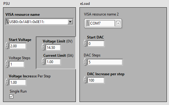

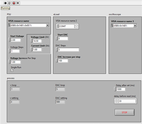

The LabVIEW GUI for this process lets you set the test conditions.
On the left side, you see the outer loop that controls the PSU voltage.
The inner loop is on the right. It controls the load.
For the outer loop, you can set the following process parameters:
  • the start voltage. This is the level that is set when the process starts.
  • the number of times you want to step the voltage for a complete test cycle.
  • the voltage increase per step. For each iteration of the outer loop, the voltage will be added to the previous value.
  • single run: if set, the process exits after it has run all the iterations of the voltage loop.
    If not set, the loop will start all over from the Start Voltage until you press the Stop button (not shown). This is a continuous test that can run forever.
For the inner loop, you have similar settings:
  • the start value of the DAC that controlls the current.
  • how many times you want to increase that DAC setting. Once all steps are done, we give control back to the voltage loop.
  • The amount of units you want to add to the DAC setting for each iteration.
All these settings are done before you start the process. Any change is ignored once the flow is execuing.

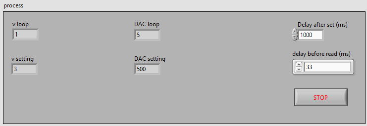

Monitor and Control
The parameters in the bottom half change - and can be changed - at runtime.
The left side show progress. You can see the counter for the inner loop (v loop) and outer loop (DAC loop).
Under each of them, you can see the value that's sent to the respective devices: PSU for voltage, load for DAC setting.
On the right you see two timing settings that you can fine-tune during the run.
The delay after set is the time that the process waits after the DAC is set.
This time needs to be long enough to have the load's ADCs take the 3 samples for A, B and C.
If you make this too short, you will get old sample values taken before the DAC has changed.
The delay before read is a communication delay. It's the time that the process waits between asking the load for an ADC value and reading the answer.
The time needed is partly driven by the firmware speed and partly by the USB communication speed.
If you make this one too short, you get communication errors and the flow will abort.

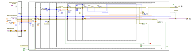

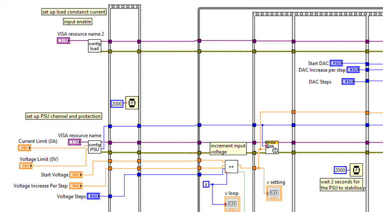

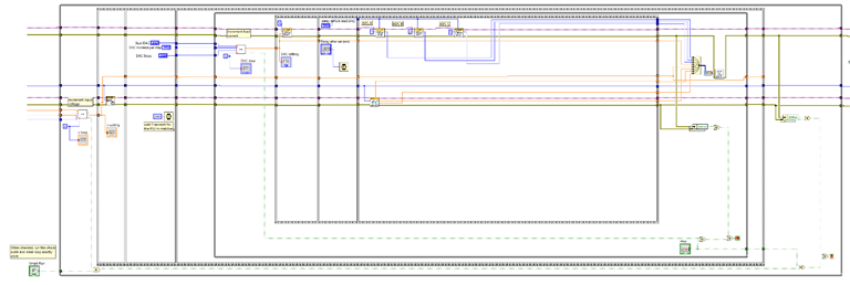

The LabVIEW Block Diagram
This is a big diagram. If you want to see it in full detail, download the attachment.

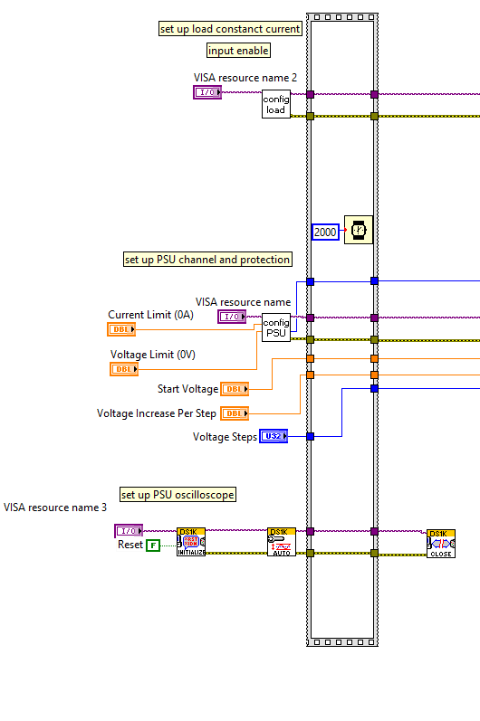

The first block initialises all devices. The PSU, load and scope are in a known initial setting when this part is complete.
Some parts of the flow are put in their own module. I've done this to keep the flow focused on the core process. This is similar to using hierarchical sheets in a KiCAD schematic.
The flow waits 2 seconds to let each instrument settle.
The next part is the big outer and inner loop.
The outer loop is, as expected, the 2 rectangles counting from the outside in.
It sets the voltage, then hand over to the inner loop that's embedded. The voltage is incremented each successive iteration.
It then waits for the PSU to stabilise on its new setting,

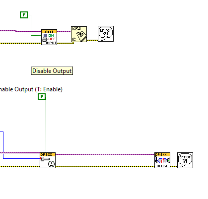

There are exit routes for when you:
  • set the Single run box and the total number of outer iterations has completed
  • the user pressed the Stop button in the inner loop.
  • an error is flagged by the error signal.
The inner loop is everything from third rectangle counting from the outside in.
This one  then sets the requested DAC value, waits for the load to sample the values, then retrieves all measurements from both load and PSU.
The measurements are done in parallel for both devices.
At the end of that inner loop, a row is written to the spreadsheet that logs the results.
There are exit routes (they also exit the outer loop!) for when you:
  • pressed the Stop button.
If the loop completes the iteration in a normal way, without the above exit routes, then it just gives control back to the outer loop, so that it can move on to its next iteration.
The last part releases all devices used in the process. Any uncaught errors are flagged to the user here.

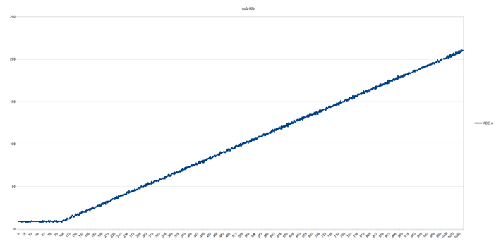

Below you see an example graph of the value of ADC A (sample of the voltage over the current sense resistor) for a range of DAC values (each measurement was a single DAC increment).
The measured voltage over the sense resistor (a function of the current the load is extracting from the PSU) is rising linear, as expected.

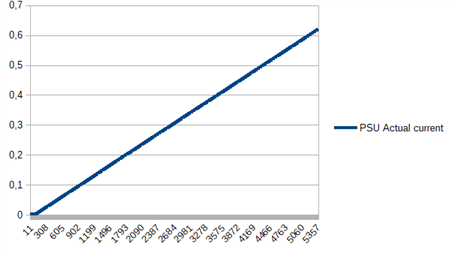

The one below shows a similar graph. This time it's the current reported by the PSU. There should be a direct relation between the two graphs above, if the current sensing circuit of the load is working correctly.

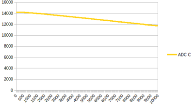

And this one is what the temperature monitor (ADC C) reports over a wider range of DAC setiings, with bigger increments:
This measurement is a function of the voltage over the NTC close to the power MOSFET. The lower the voltage, the higher the measured temperature.

    What is a temperature of 14000? Is it freezing or is it about to melt the heatsink? Couldn't you get Labview to convert it to centigrade?

    Jan Cumps over 8 years ago in reply to jc2048
    I have on purpose not done any calculations on the value sent to the DAC or any measurement I retrieve, because I wanted to collect raw data.
    The temperature is a representation of what that ADC C reads. it’s the result of the voltage divider where the NTC is part of, and the gain of the opamp between that voltage divider and the ADC C.
