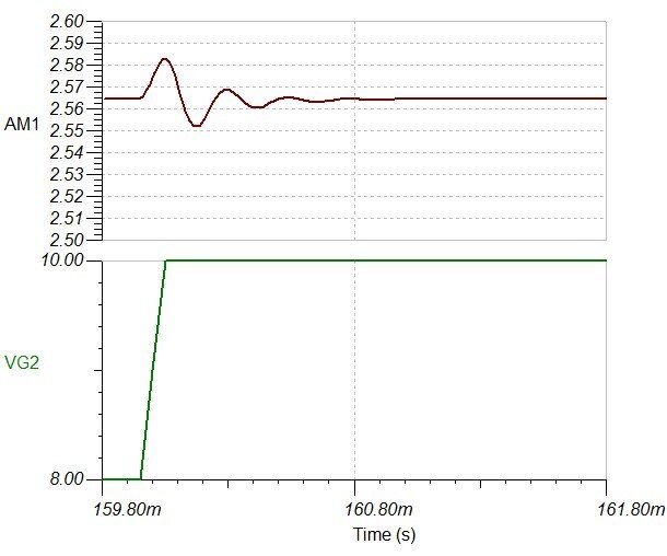

In the previous parts, I looked at the effect of changes to the control input. Now I want to look at
the effect of holding the control input constant and varying the voltage of the output. That change
of voltage will result in the circuit having to vary the resistance of the MOSFET, to compensate and
bring the current back to the desired value, and the way it deals with that change may be different
to the way it handles a change to the control input.

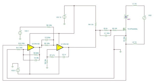

Here's the circuit, much the same as before.
Initially, I'm going to try inductance of 1mH in each
lead, which is high but will show clearly what the effects are. I'm going to step the voltage of VG2,
the voltage source for the output loop, by 2 volts up and down between 8V and 10V. That's quite
arbitrary - I just want to get a feel for how it behaves. I'm going to have that voltage slewing
rather than a step change because any real power supply would have capacitance associated with it.

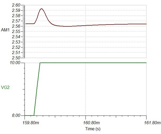

Here it is with the original compensation/servo components (C2=4.7nF and C3=100p)
And here with my alternative values (C2=1nF and C3=220pF)
I find this fascinating. Which is better? My immediate reaction was that my alternative values, which
so obviously ring, are worse than Peter's original values. And yet the excursion from the desired
value is less at its extremes and it settles quicker than the original values which, to a first
glance, looks much more controlled and graceful.

    I really didn't explain very well what I was doing and made a bit of a mess of that one. I should have gone further with the simulation and shown you the traces for different amounts of inductance in the output circuit. Part of the problem here is that I don't know the material well and often have no idea what I should be be doing - you're looking over my shoulder as I learn and discover things.
    The 1mH I chose for the blog is very large. You wouldn't see it in practice with just having connection leads, where the inductance would be more like a few uH (depending on diameter, length, and where the two wires were in relation to each other).
    Here's what happens if I step the inductance in each lead from 0 to 1mH in steps of 200uH (this is with the 4.7n/100p combination). This is with the same step change in voltage from 8V to 10V with a slew time of 50uS. Unlike the situation where we are demanding a change to the output current, which is what I was looking at in previous blogs, here the inductance actually helps us. That's because now the servo is trying to maintain the same current, which is also what the inductor wants. These higher values of inductance smooth out the change somewhat.
    Now here it is for the case of 0 to 10uH (stepped in increments of 2uH) for each lead (which is a more realistic figure for thick leads of a few metres in length):
    Now the inductance isn't having any real effect and the response is largely down to the servo. Initially the circuit is caught unaware and the current rises. Then the differentiator gets on the job and start to haul it back. The slewing stops, and again it's caught unaware and there's a sudden lurch down, before the differentiator sorts itself out and then there's the longer response of the integrator as it then hunts for the set current again.
    This next shows it for different slew times - this is for 1uH inductance in each lead and the slew varied from 10uS to 50uS. The servo manages to limit the excursion to about the same in each case whilst the change is occuring.
    Whether that's good or not I've got no idea, never having done this before and not having any experience of professional instruments. The good news for me is that it's not frightening - whatever I do to the output, the current excursion is only a few tens of milliamps, so although it may look a bit messy it isn't going to harm anything.
    I don't think capacitance is really an issue here. The only capacitance in the output loop that really affects the loop response is the intrinsic capacitance of the MOSFET. That does have an effect, but it's swamped by the integrator (the time constant of the deliberate integrator is longer than that of the MOSFET and so dominates in the circuit response). Any capacitance across the voltage source powering the output loop is the problem of the power source to handle.
