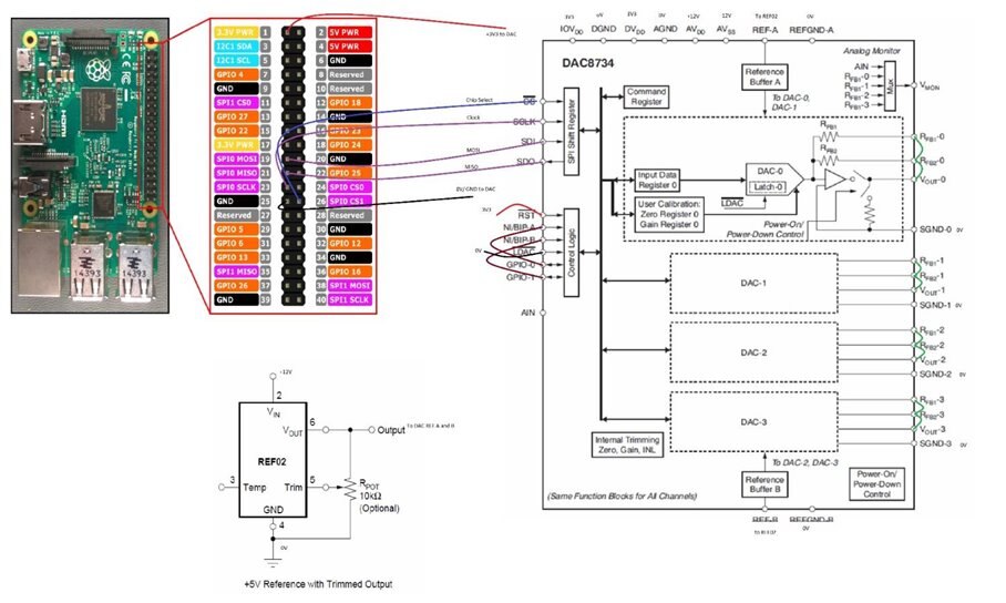

here is the rough schematic of the hardware

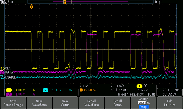

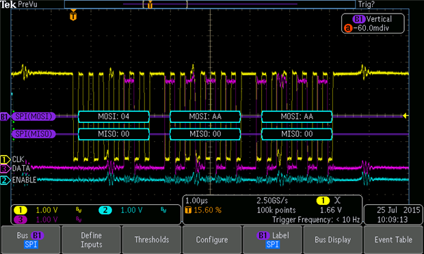

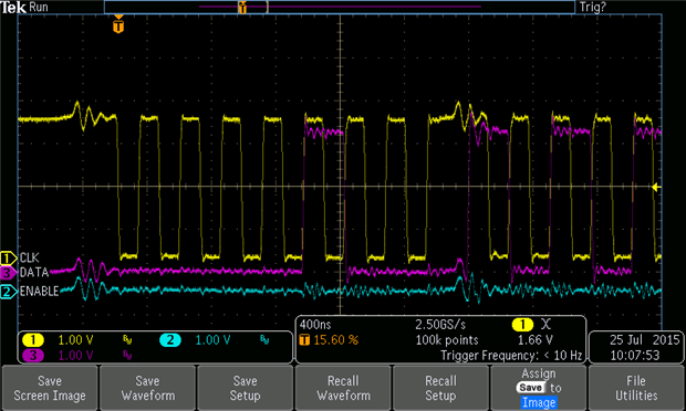

Here is a trace of the SPI but in mode 0, it was not working even though the scope was happily decoding it correctly. .

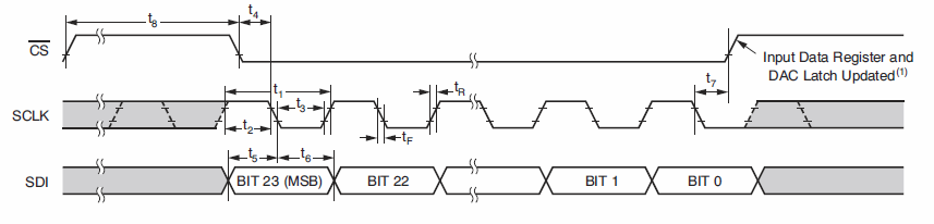

I had to refer to the PDF data sheet and closly examin the timing diagrams in order to figure it out (I guess I could have simply fliped a few parameters in the code too but then I would not learn as much. As there was little information outside of the PDF I had been able to find including a lack of sample code it was down to sleuthing. There was no mention in the data sheet of the right mode
so time to compare diagrams, here is the one from the PDF
It can be clearly be seen that the timeing was wrong on the scope even though the scope was decoding it correctly (Tek is too cleaver for its own good, it defaulted to mode 0 too image. the PDF is showing the clock falling edge is the one to use to latch in the data but the scope is showing it using the rising edge

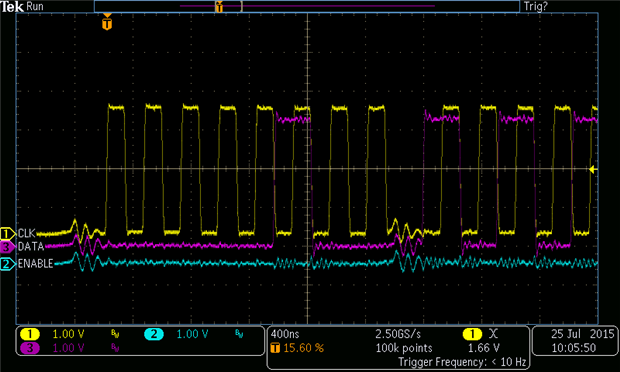

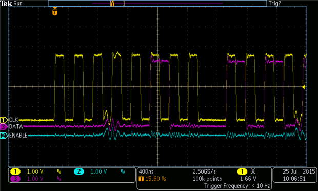

Switching the mode to 1 resulted in this trace
Bingo, the DAC was now responding reliably to my commands. Job done.

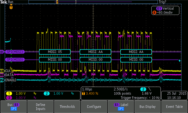

But in an effort to provide a little more education I went further and captured a bunch of traces with each mode from 0 through to 3 so you can clearly see the differences in the clocking in relation to the data
Mode 0 (Normally low level clock when idle, clocking in the data on the rising edge ). Yellow trace is the clock if you did not get that already image. Purple is the data and blue is the chip select (Off screen start due to a slow Win10IOT SPI driver)
Mode 1 (Normally Low clock when idle, clocking in the data on the falling edge of the clock). This race is outputting to dac 1 which is why the first byte is a 5, Register offset to the DAC output register)
Mode 2 (Normally high level clock when idle, clocking in the data on the rising edge ).
and finally
Mode 3 (Normally high clock when idle, clocking in the data on the falling edge of the clock).

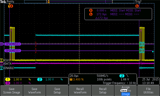

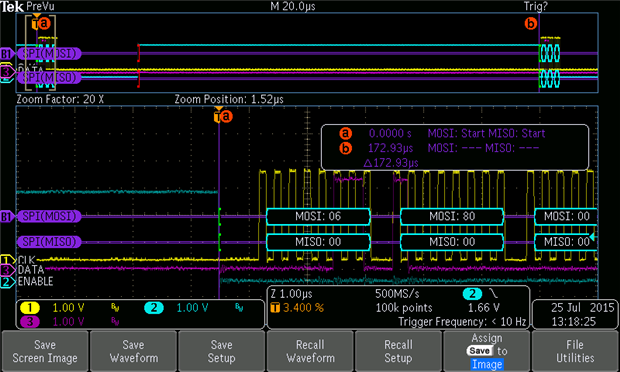

so there was clearly an issue with the Windows 10 driver (Ill report that to MS), to confirm this I captured the SPI bus across two itterations
the complete trace between two outputs, I have a cursor on to show the timing o 172.9uS, bu you can clearly see how long it takes to release the chip select line after the data has completed transmission, and then the horendious time before the next loop

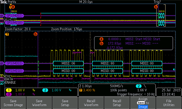

this is a close up of the two bursts of data in the above trace
As you see, nothing wrong with the actual transmission.
