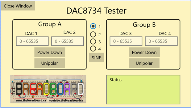

this is what the APP looks like once up and running on the PI
the first thing to look at is the code to layout the screen, if your familuar with HTML and how event handling works with ASP.net or other IDEs then it will be all too familuar, it really is all down to how the compiler and backend integration works that makes this different from older development techniques,
The Windows 10 for IOT on the PI uses XAML "Extensible Application Markup Language" , see https://en.wikipedia.org/wiki/Extensible_Application_Markup_Language
here is the code that will render theUI for the app

This is all of the XML to render the page, and for me this was 99% drag and drop from the tool menu in visual studio 2015 community edition RC
If you look closely you will see the statements used to hook up the event handlers that exist in the "Code Behind", and example is this    TextChanged="DAC3Val_TextChanged" KeyDown="DAC3Val_KeyDown", this shows 2 event handlers for a text box, and simply wires the UI element to C# code
this is the C# code

The first function triggers every time a key is pressed on the element in focus (DAC3VAL in this case) and as you can see, will only really do anything if it is an enter key that was pressed
the second function triggers every time the value of the element changes, this could be because of a key press if the element was in focus, or it could be from a paste, or a code section directly changing the value , perhaps from the reading of some sensor (Not in this app though). by the way, this text box is the one directly under the words "DAC 3" in the above UI image.
As I said, if you have coded in Visual Studio before or any other language that has a graphical designer and supports event handling then it will be all too familuar. I am not going to try to teach you how to code here, just show you how to drive the DAC8734. We just need a UI in this case to do that. for the rest of the elements on this page, I will leave you to review the code yourself, if you have any questions, by all meand add a comment below and Ill try to answer them for you

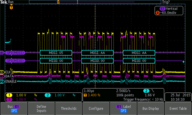

Here is a sample SPI bus capture that shows the data 0xAAAA (Hex) being sent to register 5 (The DAC1 data register

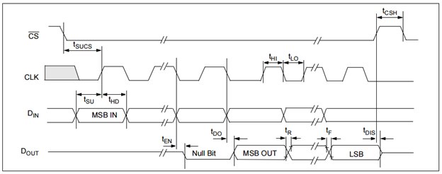

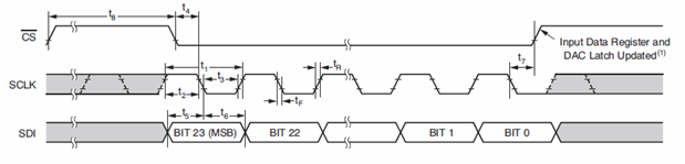

It is important to review the data sheet when deviding which mode of the SPI clocking you need to use
this above is for the DAC8734 and corresponds to Mode 1. other vendor including TI devices may need different modes
for instance, this is the timing for a Microchip MCP3208 and as you can see, it needs mode 0
Notice the difference in the clocking edge

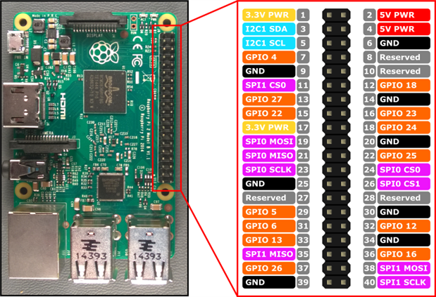

        private const string SPI_CONTROLLER_NAME = "SPI0";  /* For Raspberry Pi 2, use SPI0                             */
        private const Int32 SPI_CHIP_SELECT_LINE = 1;       /* Line 0 maps to physical pin number 24 on the Rpi2, line 1 to pin 26        */

The "SPI_CHIP_SELECT_LINE" is a constant and is either 0 or 1 for SPI0, it can only be 0 for SPI1 (This is the supported features on the PI), the chip selects corespond to the respective pins on the PI GPIO, note that SPI1 and SPI0 also have different MOSI, MISO and SCLK lines meaning you can have upto 3 physical SPI devices on the PI (This may be more logical than physical as there are techniques that allow multiple devices to share a single CSz line, this includes the DAC8734 that can be daisy chained with other DAC8734s.
