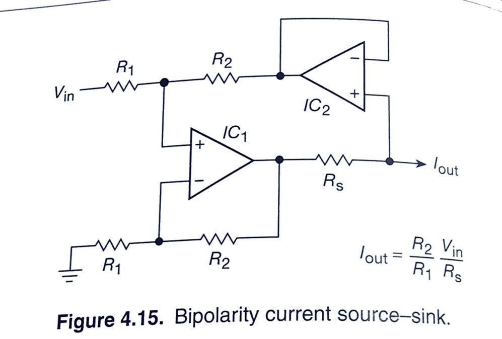

 shabaz designed an OpAmp based constant current source. It can deliver up to 1 mA. The current is controlled by a voltage. It's intended to be used with a DAC board for the Raspberry Pico. A constant current is a useful lab instrument. It can be used for testing semiconductors, and in sorts of circuits where components are driven by a current.
Specification:
  • constant current between 0 and 1 mA
  • control voltage: 0 - 1 V
  • compliance: 3 V (4.5 V with a LM324)
  • power rails: - 1.5 V and + 3.3 V (+5 V with LM324
How does it work?
High level: the circuit is built around a differential amplifier design (UA1). See also the internals of an INA106 differential amplifier a bit further down this post, and try to find similarities to this circuit.
image source: shabaz' schematic
I removed the two extra current drivers U1C and U1D for the time being, to make the likeness more striking. We 'll add them back later and tell how they impact the output current.
I also made reorganising changes, that don't alter the circuit: I 've drawn U1B pointing back, and moved a few resistors up-down, to make the next step in the analysis easier.
image source: shabaz' schematic, edited
The exact same circuit is discussed in The Art Of Electronics. They draw it a little different, with the feedback x1 gain buffer pointing back. My edits of the original circuit (above, with Microsoft Paint) were done to show the concept similarity.
image source: my copy of The Art Of Electronics (TAOE), 2nd edition
In the drawing of shabaz, and in the TAOE schematic, you should now clearly see that it's identical to what's inside a differential amplifier:
image source: TI (BB) INA106 differential amplifier data sheet, edited. I flipped the original drawing vertically, to show the same orientation as the circuits above
Note that if you 'd use Reference and Sense as +In and -In, and vice-versa: use +In and -In as Reference and Sense, it would be an almost perfect (better, because R1 -> R4 are factory-matched in the INA106 !) drop-in replacement for U1A.
So we can summaries that the circuit works like one, and measures the voltage over the sense resistor (R5 in shabas' design). It measures the voltage over the sense resister (that also means: the current through it), and tries to keep the design stable. If you add voltage to the reference input (U1A in +) , it will increase the voltage over R5 to get back into balance. Thus, more current will flow through R5, and we increase the constant current output. The differential amp keeps this in balance.
The buffer at the output (U1B) takes care that there's no current error. It feeds back the output voltage without loading that output.
In TAOE, we can see that the formula for output current is:
If we plug shabaz' values in that formula:
the outcome = (3300 ohm / 99000 ohm) x (1 volt / 100 ohm) = 0.333 mA.
But the specs say it's 1 mA. Why the difference? That's where the two current drivers U1C and U1D and their output resistor come into place. They have a gain of 1, take care that the same current is sent additionally to the exit node. 3 x 0.333 mA = 1 mA.
Another way of seeing it, is that the combination of Rs (R5, R6, R7) is an "active 33 ohm resistor". If we plug that value in the formula: (3300 / 99000) x (1 / 33) = 1 mA.

    Good blog! Few random thoughts and ideas 1. Output compliance with an old LM324 won't be 4.5V on a 5V supply (the top driver is a darlington pair, so there's at least 2 Vbe drops down from the rail…
  • jc2048
    jc2048 over 2 years ago in reply to Jan Cumps +1
    This is what Tina-TI shows for sweeping the compliance voltage slowly over a second. That's using Microchip's model for the opamp as it comes. It won't match reality for several reasons, but it's…
  • jc2048
    Good blog!
    1. Output compliance with an old LM324 won't be 4.5V on a 5V supply (the top driver is a darlington pair, so there's at least 2 Vbe drops down from the rail for it to operate).
    2. I don't think the LM324 version will be very accurate. May not matter - depends what you want to use it for.
    3. The spread of offset voltage for the MCP6024 is -0.5mV to 0.5mV. It looks from the datasheet to be 'normal' (bell shaped curve), so, if you have a few of the devices, it might be worth testing them to see if you happen to have struck lucky and got a particularly good one in amongst them.
    4. If you put some resistance in series with pin 5 of U1B, the MCP6024 version might survive the output being connected to 5V.
    5. At high frequency, the PSRR of opamps isn't that wonderful, so you may want to examine the supply side of things in more detail. At its simplest, that might be a 10R resistor before the decoupling cap, or something like that for a bit of filtering.
    6. How much variation are you seeing in the current as you sweep the output across the compliance range?

    shabaz over 2 years ago in reply to jc2048
    Hi Jon,
    Those are good comments, and LM324 may not be sensible at all, it might be worth eliminating that from the schematic notes. I was only looking to see what quad op-amps I had that were in that SOIC package and might be compatible with that test board. I think the 3V compliance is already useful for semiconductor testing, so maybe there's less need to want to go higher, and MCP6024 is in no semiconductor shortage so hopefully there is no need for an alternative for the 0-1mA range.
    Incidentally, there's also another thing that would be interesting to work out, but I haven't gotten anywhere with so far: I'd like to find an op-amp with higher supply voltage, sufficient current output, and the same quad package that would work for a 0-20mA or 0-25mA range. The reason was I was hoping that then two PWM outputs on the Pico (there's a separate 2-channel isolated PWM2ANA test board) could be used, one for 0-1mA, and the other for 0-20/25mA, to extend the usage for more curve tracing capabilities with the Pico, or for industrial devices. Also, the 0-1V output from the PWM2ANA could be amplified to (say) 0-4V (to keep everything running from 5V) or perhaps 0-10V or something, so that when the constant current feature is not required, the user could switch to a voltage source output. Not really thought it all through much : ( Everything is small building-blocks, but needs some ideas to try to make it into a little Pi Pico test instrument.
    (can't edit) Regarding offset, one idea could be to have a little EEPROM on that board for storing the value.
    Jan Cumps over 2 years ago in reply to jc2048
    I haven't tested this yet. I only used a current meter - in fixed range - as load. An easy scenario for this design.
    Plan is to repeat the exercise with higher load resistances, where Vout gets closer to the + rail. And with a diode or a LED, that doesn't have linear behaviour.

    You could try OPA4192 (available in SOIC, same pinout as MCP6024)
    OPA4192 approx £6 each
    offset 25uV, max output current approx 20mA (1V drop), max supply (working) +/-18V
    MCP6024 approx £2 each
    offset 500uV, max output current 10mA ??, max supply working +/- 3V
    The OPA4192 has a higher GBWP which may or may not be helpful.
    You might have stability issues with this circuit - because there are op amps in each others' feedback path. Making provision for adding compensation caps might be a good idea in a future pcb design.
    Looking at the pulse response in simulation (with non resistive loads) will give you some clues.
    MK
    shabaz over 2 years ago in reply to michaelkellett
    Ah awesome, that op-amp looks ideal for the higher current scenario.
    Thanks for the compensation cap tip, I'll get space for those added in the next revision. I was hoping the series 100 ohm resistors would support a small amount of capacitive load, but it will be worse especially for the higher current output.
    I've downloaded the OPAx192 spice model, and confirmed it works in the KiCad 8 simulator incidentally, so I'm going to add that to the project files, so anyone who ever uses the CAD files, will also have access to the simulation.
