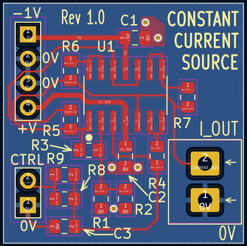

 shabaz designed an OpAmp based constant current source. It can deliver up to 1 mA. The current is controlled by a voltage. It's intended to be used with a DAC board for the Raspberry Pico. A constant current is a useful lab instrument. It can be used for testing semiconductors, and in sorts of circuits where components are driven by a current.

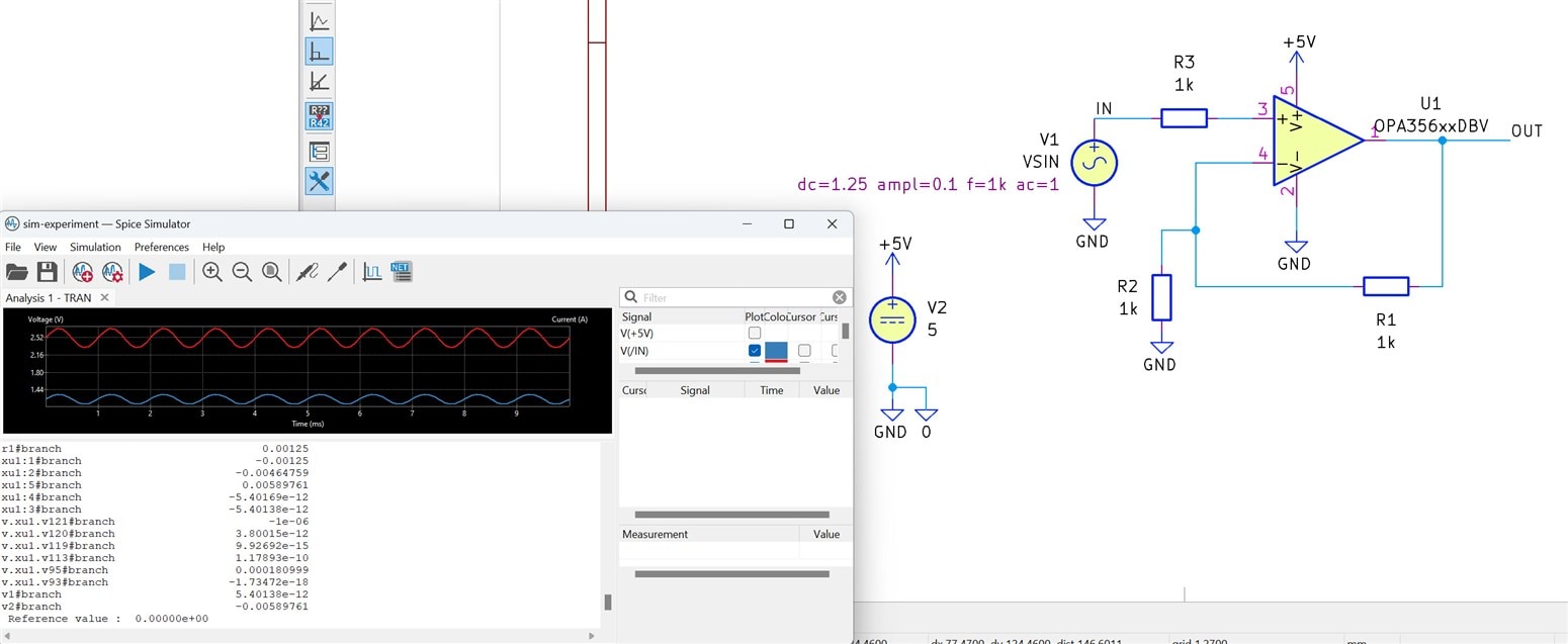

    Nice work with the simulation! I gave KiCad 8 simulator a shot for the first time the other day, and while I got it to function, it makes LTSpice look like a breeze to use in comparison. KiCad simulator is really tedious to use, I hope they put usability improvements into it in a future release. Obviously it would be major work, but it would be great to see one day, since there's always the hope that it would be less legacy incumbered in its UI and could suck in several open source simulators for different types of circuits.

    Of course, there's another source of inaccuracy, that this simulation doesn't even touch, and that's the resistance tolerances. For a one-off, matching values and ratios between values is quite possible, with a bit of effort.
    Jan Cumps over 2 years ago in reply to jc2048
    I didn't use precision resistors (E24, 5%) nor checked if the ones I used match. They are from the same cut tape - so I expect from the same batch - though.
