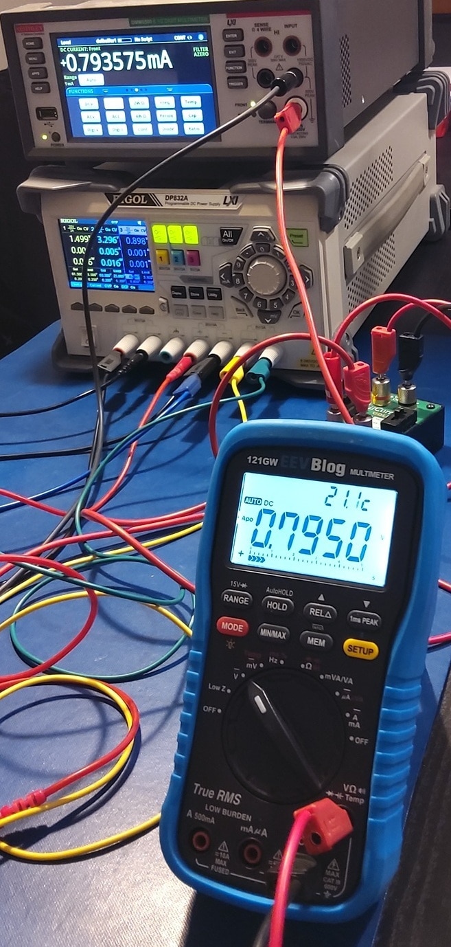

    Jan Cumps 9 months ago
    I own an EEVBlog µCurrent. I had some incorrect low current measurements when I used it lately.  Time to check if it's a test setup error, or if the µCurrent is off.
    The current source of this blog is a decent source to compare the µCurrent measurements vs a reliable bench meter (Keithley DMM6500).
    I put the µCurrent in series with the DMM. First nulled out the 2 devices. I dialed in a somewhat random current on the source. Then checked if the result is somewhat in the same range.
    Turns out the µCurrent is still good:
    I used the µCurrent's µA setting, where 1 µA generates a 1mV output.
