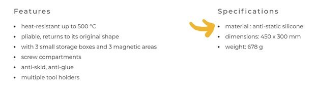

I purchased a silicon solder mat today, when I was in the electronics shop to pick up my order.
I use an antistatic mat as a generic work area, and prefer to keep that tidy. That mat can take an accidental touch of a hot iron, but it's not intended for that.
The silicon solder mat (from Velleman - Buy Belgian!) is heat resistant, up to 500° C.
Flexible and can be cleaned in a kitchen sink. It returns back to its original form.
Total size 45 x 30 cm. Work area without covering anything is approx. 40 * 28. It costed 20 €.
One of the biggest advantages for me is that it's easy to pick up and stow away. My lab is used as office, diner table and lab bench, depending on the time of day.

    Correct me if I'm wrong, but I don't believe these mats are anti-static which is a concern.  I noticed that they don't seem to have a grounding contact.  There may be an static dissipative spray, like the film on a "pink" or "blue" poly bag that can be used.

    Jan Cumps over 5 years ago in reply to gordonmx
    The box says it's ESD safe.

    Jan Cumps over 5 years ago in reply to dougw
    It works as you say, Doug.
    Note that the mat is not a solution for ESD issues. It's a solder mat. It's safe to use it in an ESD safe environment and does not introduce extra ESD risks.
    The graphene takes care that there can't be spot buildups of static.
    There is a second component needed, just like with an ESD math. A path to bleed off.
    The silicon mat relies upon the fact that the surface you work on has that capacity.
    If you worked day 1 without the mat, and your work space is not ESD safe, you have issues before you use the mat. The mat will not solve your ESD issues.
    If your workspace was safe on day 1 before you had the mat, then putting the mat on that surface will keep the ESD measures intact. It will conduct to your safe desk.
