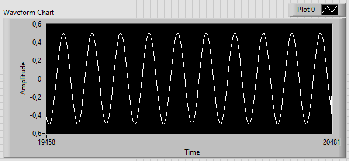

    Sample of a 500 Hz, 500 mVpp waveform:
    settings:
    • sample rate 51200 samples per second
    • 10240 samples per channel
    • sensitivity 1000 mV (this doesn't impact measurement but takes care that a mV measured is a mV reported)
