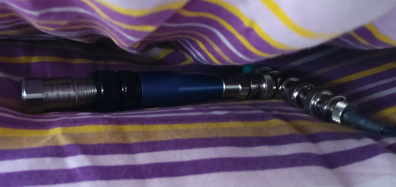

    I'm putting the sensor between two pillows to try and avoid external interferences.

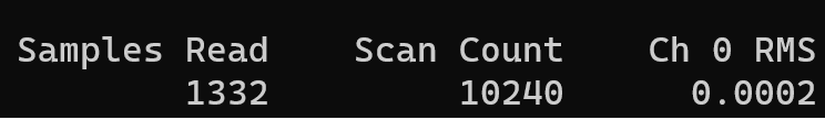

    Here are the results. I used the finite_scan_example
    It returns the VRMS calculated using 1000+ samples.

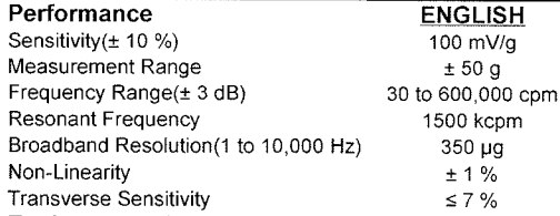

    The sensor is 100 mV/g. 0.2 mV should be a noise of 0.2 g RMS.

    Looks cozy lol

    Thanks for the response, no need to go overboard. If memory serves I believe 100 ug/rtHz was a competitive noise spec for digital output MEMs accelerometers and that would at a +-2g full-scale range. Your system has a much larger dynamic range and many 10's of kHz more bandwidth Slight smile really neat roadtest kit!
  • scottiebabe
    scottiebabe over 4 years ago in reply to Jan Cumps
    I forgot to add, I think the math is 0.2/100 = 2 mg rms
