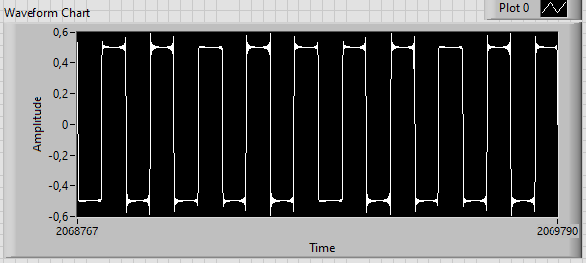

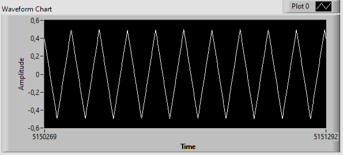

    Jan Cumps over 4 years ago in reply to Jan Cumps
    Same settings, square wave
    and triangle
