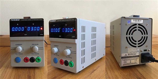

Thanks to Project14 and the Electronic Toys contest I have a new bench power supply!  Thanks tariq.ahmad.  In this blog I will outline why I selected it and my first impressions.  I also do a quick out of the box check to make sure things seem to work as they should.

Unboxing
It came nicely packaged and undamaged in a box which I shall keep in case I need to transport it.  The instructions are terse but sufficient.  My unit has a North American 110 V mains power cord (it is switchable to 220V).  It does not come with leads.
Quick Look Around
This is a basic power supply so our tour won't take too long.
Front:
  • The digit display is bright and easily read from all angles.
  • There are bright LEDs for Constant Voltage, Constant Current, Lock, and Over Current Protection
  • The encoder controls for current and voltage are great!  They allow precise setting and are reasonably quick to set once familiarity is gained
  • There is a power on / off button (blue)  which completely turns the unit on and off
  • There are ground, positive and negative terminals that accept banana jacks - there are no binding posts
Sides:
  • Ventilation
  • Four Phillips screws on each side to hold case together
Back:
  • Fan exhaust (runs only when needed)
  • Power socket and switch for 110 or 220 V
  • Fuse accessible from outside with a spare fuse
  • Approx. 1.1 meter power cord supplied
Top:
  • Handle
Bottom:
  • Four rubber feet
Overall it looks good and well built from the outside.

I am quite pleased with the Tenma 72-268572-2685 and recommend it for those looking for an inexpensive entry level bench DC power supply. Setup is easy and resolution is very good for an inexpensive power supply.  The unit met or exceeded the specifications in the areas I tested. The 72-268572-2685 current control does not perform as well as I would like at very low currents but it meets the specifications and the specifications are superior to the other low cost units I looked at and match some higher priced units in key areas. The power supply seems well built and was an absolute bargain at the discounted price of $68.02 at which it was purchased.  This is only about $10 more than I paid for my "eBay special" and there is no comparison in terms of performance or quality.
