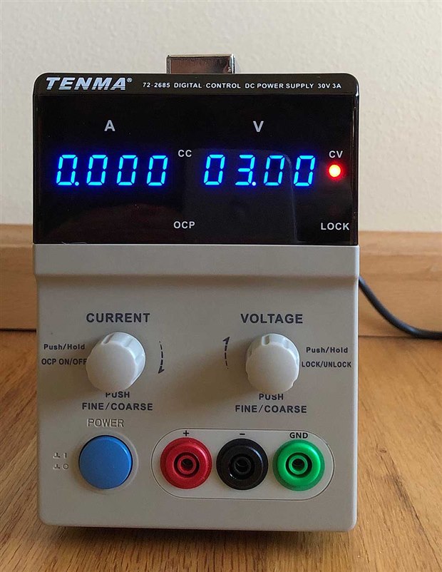

Front:
  • The digit display is bright and easily read from all angles.
  • There are bright LEDs for Constant Voltage, Constant Current, Lock, and Over Current Protection
  • The encoder controls for current and voltage are great!  They allow precise setting and are reasonably quick to set once familiarity is gained
  • There is a power on / off button (blue)  which completely turns the unit on and off
  • There are ground, positive and negative terminals that accept banana jacks - there are no binding posts

I found the user interface fairly easy to use once I got used to it.  Setting a value is not as quick as rotating the potentiometer on my other bench power supply but it is WAY MORE PRECISE with the encoder on this unit.  Voltage is easily set to within 0.01 volts and readout is quite accurate as can be seen from the table.  A somewhat minor complaint since this is an entry level supply is that settings and readout are not displayed at the same time.  To get a setting it is necessary to push the adjustment knob which then displays the set point.
Current adjustment can be done down to 1 mA, but readout and setting accuracy is not as accurate as voltage.  As can be seen from the table (note that PSU readings are in A while DMM2 is in mA), readout does not occur until the current approaches 5 mA measured with the DMM.  Readout accuracy is not given in the specifications, and this is much better performance than my other bench PSU but it was still a bit of a disappointment.  I decided to test with a smaller resistor in order to see how it performed at higher currents.  In the following table a 10 ohm resistor (measured to be 10.05 ohms) was set up as described above.

I am quite pleased with the Tenma 72-268572-2685 and recommend it for those looking for an inexpensive entry level bench DC power supply. Setup is easy and resolution is very good for an inexpensive power supply.  The unit met or exceeded the specifications in the areas I tested. The 72-268572-2685 current control does not perform as well as I would like at very low currents but it meets the specifications and the specifications are superior to the other low cost units I looked at and match some higher priced units in key areas. The power supply seems well built and was an absolute bargain at the discounted price of $68.02 at which it was purchased.  This is only about $10 more than I paid for my "eBay special" and there is no comparison in terms of performance or quality.
