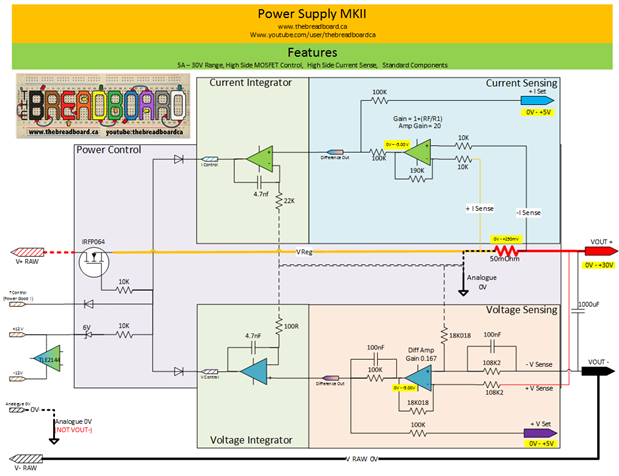

Ok, so based on the last two or three videos an posts it is time to test everything out on the bench with a breadboard and read power to see how it performs
so this is the final schematic I have, I still am pondering changing it up a bit more but I will play with it a little first, ideas I have are around using 10V control signals instead of 5V and of course adding a pre-regulator switching in order to reduce heat dissipation in the regulator significantly, but thats for a future epesode image
RPO: The Schematic was updated to reflect the correct volts on the op amps of +12 and -12

    yes, the op amps are running on their own 12V +- supply, 9 volts would also work ok. there are many techniques you can use to derive the supply for the op amps but it does need to be isolated from raw…

    But just to be clear, the op-amp 0V, is floated onto the positive rail of the main raw power supply (as a reference), just before the sense resistor?
  • Robert Peter Oakes
    Robert Peter Oakes over 10 years ago in reply to nikolajbrinch
    yes, the op amps are running on their own 12V +- supply, 9 volts would also work ok. there are many techniques you can use to derive the supply for the op amps but it does need to be isolated from raw PSU supply as it is "Floated" onto the output rail of the power output. so the 0V of the op amps is NOT the same as the zero for the main power supply.
    The opamp in the schematic with the actual +- connections is representative as you correctly identified.
    As the supply for the control (Op Amps and later the uController) will not draw much current so it can be built from small power adapters, PCB Power bricks etc or as you say, another small transformer. then again, you can get transformers with separate low current windings available for this purpose. Just need to shop around.

    I love your series on the power supply. Of course ideas about soft start, short circuit protection, bleeder resistors and output on/off comes to mind, as other modules that I would like to see integrated in the design. I must say that the simplicity and the use of that beefy MOSFET, and the theory and use of the op-amps are all extremely nice, and well laid out.
    One thing I need to have confirmed is, that the control-circuit that needs +/- 12V is a different power source all together? So i.e. 4x9V cells in series with a center tab could provide the power (in theory - in practice a dual source with a separate transformer, rectifier, caps and regulators - 7812/7912 probably)?
    Furthermore, there is an op-amp in the schematic on the +/- 12V input, is that to be disregarded as a symbol of how to connect the other 4 op-amps?

    There is a small error on the diagram.
    The +12V is labeled +2V.
    You may want to clean-up the connections to the feedback resistor of the voltage comparator.
    Your schematic capturing probably messed that up.
