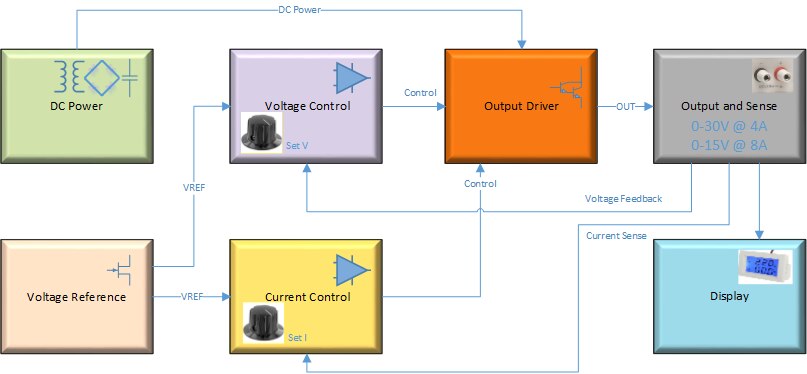

My ideal target specifications
There will be three significant parts that can be built as separate projects or included into the Power System
Dual Channel Power Supply each outputting 30V @ 4A or 15V @ 8A, user selectable, independently adjustable
DC Load 60V /10A (But not 600W image ) controlling  Volts and Current
Power Meter showing Watts, Watt Hour, Volts, Current
Battery Charging Profiles
Logging on all modules above
Network and USB support for LXI and VISA protocols (SCPI)
All modules controlled by micro-controller/s with a master control unit based on embedded Linux
4" touch screen display / control
Speech Output
Not all of the above features are needed or essential, and there is no need to build yours to the same specification, I will tell you where the opportunities are to put in parts to meet your budget and requirements
The main power supply is broken down in to several sub modules as follows
Voltage Reference circuit, providing feeding the other modules
DC Power, this module converts the mains supply to a safe and smooth voltage for the rest of the supply
Output Driver. This module will be  power transistors providing the actual limiting of the output to supply channels
Output and Sense, this is the actual output and also the voltage sense circuit needed for control
Voltage Control module set and vary the desired output voltage of the supply
Current control module will allow the user to pre-set the current limits of the power supply outputs
Displays and Controls, how else will you see and adjust things image
We will start with the basics, a backgrounder on the modules purpose and basic functionality, the simpler analogue design and accurate enough for basic projects, this will help you understand Voltage references, OP-AMPS, feedback loops, Curent shunts both high side and low side and the benefits of each
Later, once we have the basic PSU working, we will upgrade modules to improve the regulation, accuracy and then some form of digital control in the form of a micro-controller, at this point we will discuss ADC, DAC resolution, over sampling etc.
This is a block diagram of the first modules we will tackle:

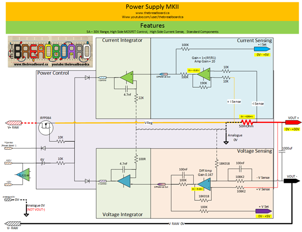

    jw0752 over 9 years ago in reply to omnacron
    There are several factors that may cause you trouble testing the current design as a prototype on a bread board. Substitution of the value of the shunt resistor that was in Peter's design would necessitate a corresponding change in the sense voltage resistive divider. The quality of the connections that can be made on a bread board and the resistance of the wires that make the connections could drastically affect the resistance. I would expect the problems to become worse as a higher current is selected. The use of lower voltage to power the op amps would limit the ability of the op amps to raise the output voltage. Unless you have a lot of design experience your best approach will be to build your project as close to Peter's design specifications as possible. As you understand the circuit you will be able to make some modifications and get the result you are seeking.

    omnacron over 9 years ago
    Just to give a general idea of what my end game looks like i am going to run 0-32 volts around 8 amps. What i will be changing in the diagram is the transformer and rectifier and i will be changing the tip31ag to a 2n3055 npn waiting on the heat sink for the 3055. Also I am thinking of using the ATX as a secondary supply and powering the Op amps of the rails of that supply so that i dons't push the op amps so close to the max V. But that part is still on the idea board.
  • omnacron
    omnacron over 9 years ago in reply to jw0752
