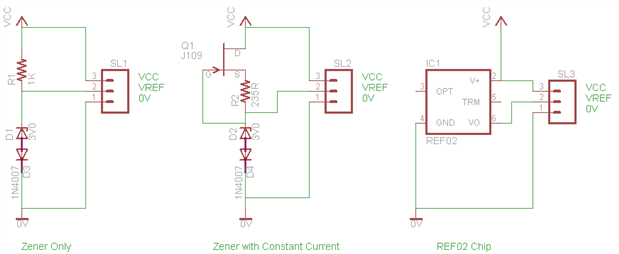

Every good power supply depends on a good voltage reference, it provides the anchor to keep everything stable and performing well and accurately
Without a good voltage reference, your supply will drift over time, with temperature changes and if the supply voltage changes even a little, not to mention noise that can be introduced by outside sources
What I will show you over the following two videos is a bit of theory and a practical demonstration of how the above things can interfere with the workings of the reference and therefor the rest of the power supply
I will exaggerate the problems by using a hot air soldering gun, an Arbitrary Waveform Generator and significantly changing the source voltage for the reference circuit
I will only show 3 variations which should represent the most popular techniques
A Zener Diode 3V _+ 5%
A Zener Diode with a JFET constant current source and an offset silicon diode to assist with temperature stabilization
A Silicon Chip reference device (REF02 in this case from TI but this is one of dozens of choices available) that outputs a stable 5.000 Volts
First up the theory:
Now time to turn up the heat... Literally image
These are the circuits I used in the above videos, the video used a bread board, the circuits are assuming a plug in module but the circuit is the same either way
Conclusion
USE A REF02 OR SIMILAR DEVICE, ITS NOT WORTH THE HASTLE OF THE ALTERNATIVES
If you disagree, lets hear it, this is just my opinion and I would love to hear yours

So yes the REF02 is significantly more expensive but were still talking under 4$ for the part and watch the video to see the rest

    Hi Peter,
    Thanks again for the wonderful videos. Please excuse my ignorance, and also the fact that this is not the main topic in your presentation, I thought a while, but could not figure out how you are connecting the power supply and the signal generator to test the v. references. I could be totally mistaken here, but I thought you had mentioned that the ground leads of the two instruments are connected, in which case the 20V potential on the output of the p.sup. should drive some current into the signal generator oscillating at 5 V p-p. If the two are connected in series, then the same current should go through both of the instruments. What is the point I am missing here?
    I am assuming here that a p.sup or a signal gen. should not be connected to a circuit that in itself has a voltage source, maybe here I am mistaken.
    Regards, Gilbert
