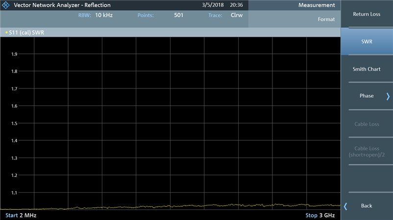

Huber and Suhner 50 ohm SMA Terminator
First off I examined the high quality load, which is a Huber and Suhner 50 ohm terminatorHuber and Suhner 50 ohm terminator. I tested between 2MHz and 3GHz. For this entire range, it looks like a single dot in the center of the display.
It is hard to see it, but it is right there in the center – at the position which represents 50 ohms (the position is marked 1 but the scale is 1:50).
The VSWR chart also shows what a good 50 ohm termination it really is – it is a nearly flat line of 1.0:1 VSWR for this entire frequency range. Toward the upper frequency range it reaches around 1.03:1 VSWR which is still tiny, and some of that will be due to cables and connectors.
