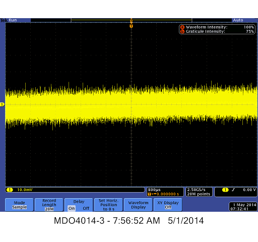

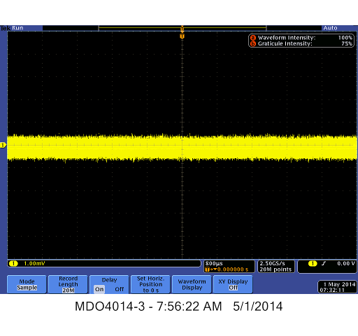

    all electronics have an inherent noise, including oscilloscopes that cost more than a home. with any amplifier circuit, as gain increases so does the noise.
    it would still be visible if you shorted your input to ground. your only seeing internal noise, with nothing connected.
    this is without probe.
    same settings with probe attached.

    My main concern was that on the lowest settings, it is over a full division of noise, with a 8 bit ADC less a bit for overshoot management, you have say 250 count, so 30 count per division , that's well over 10% noise on the range

    The thermal noise from a  1k resistor over a 1GHz bandwidth is 127uV, from 1 1M resistor it's about 4mV which are about 0.762mV and 24mV pk-pk respectively. If you are using  a x10 probe it is the 1M case that applies, regardless of the actual source impedance but the scope will multiply the reading by 10 so the indicated noise will be 240mV pk-pk.
    I set my scope to 200MHz bandwidth and with a shorted =10 probe I got 9.5mV pk-pk (1Gs, LeCroy 610zi) -  the expected value is 10.8 mV pk-pk.
    So I conclude that the scope is not noisy but as Gough suggested is just showing what physics says should be there.
    Of course this was only one quick experiment with one scope.
    And watch out for those x10 probes - handy but noisy !
    (thermal noise data from Thermal Noise Calculator one of many such pages on the web).
    MK
