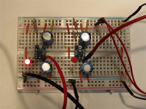

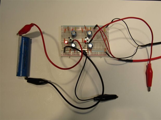

    Your recommendation of the MCP 73831/2 Li-ion charge management chip is very appreciated. I have finally received some of these chips and I have begun to experiment with them. Since they are SMD I mounted them to adapter boards so that I could use them on the bread board as DIP 6. Here is the bread board with two individual chargers set up.

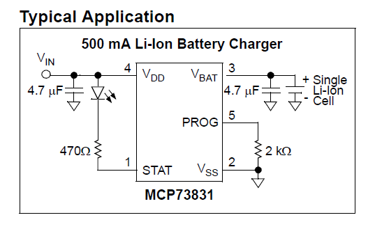

    I used the typical application schematic from the data sheet to wire the circuits. This chip is very user friendly. It is programmable so that the Max charging current can be controlled by changing a resistor between the Prog pin and ground. The optimal charging current is between 1/2 and 1 C. By using a 2.2K resistor as the program resistor the constant current during that phase of the charging is 450 mA. I experimented with other values and settled on using a 3.9 K resistor as my little adapter boards did not provide much of a heat sink for the chip.
    The chip is thermally controlled so that the chip will self protect to a lower current if the junction temperature gets above 150C. Because of this protection my chip was running at 250 mA even though I had it programmed for 500 mA. By changing the program resistor to 3.9K I just brought the charge level back to a point where the junction temp stayed below 150C. The program resistor can also be used as an enable/ disable to the charger. If the resistor is left floating the circuit shuts down. This would enable interfacing with a micro controller.
    The chip has many conditions that it checks and then decides how best to charge the battery. If the battery is very low it initiates with a precharge protocol to get things started and then transitions to constant current. The point when it transitions to constant current is when there is the most heat stress on the chip. The supply voltage Vin is typically between 4.5 and 6 volts. With the battery at a low voltage level and the current at the program limit there may be as much as a 3 volt drop at 500 mA across the chip at this point. This is a lot of wattage to shed from a small SOT23-5 package. By automatically lowering the charge current as needed to control the heat the chip charges the battery and as the voltage of the battery increases the heat problem ameliorates. When the voltage of the battery approaches the terminal voltage the chip switches to a constant voltage phase and eventually shuts down when 4.2 volts is reached. The chip has versions available for 3 different terminal voltages. The final digit on my chips "2" designates them as 4.2 volt chips. The chip also has a status pin that will turn an LED on or off to give a general indication whether the chip is in standby or charge modes.

    0 genebren over 8 years ago in reply to jw0752
    John,
    Great job on the charger and an excellent description of its functionality and operation.  The specification sheet for the device does a good job of describing the operation, but it also obscures some very valuable information.
    The PROG pin - current programming and floating the pin to disable the device.  Yes, but a more useful fact that the specification does not highlight well is that you can also drive this pin to VCC to disable it.  This is a bit more microprocessor friendly, as you can tri-state a connected GPIO and then switch it on and drive it high to disable it (i.e you do not need to psychically remove the programming resistor to disable) .  Also, you can monitor the voltage on this pin to determine the actual charging current.  A reading of 1.0V represents 100% of the programmed current value and a reading of 0.0 would represent 0% (although the device never really drive below 5%.
    Glad you had a little fun with this chip.
    Gene

    0 jw0752 over 8 years ago in reply to genebren
    Hi Gene,
    Can you clarify the voltage on prog correspondence with current. Since the current of the output goes up as the resistance between prog and ground decreases it would seem that 0 volts would be 100% and Vcc would be 0%.
    John,
    The programming resistor sets the maximum current value (2K = 500mA).  In normal operation, when the charger is applying the maximum current, the voltage on the PROG pin will read 1.0V.  If the charger is limiting the current to 250mA, or 50% of the maximum value, the voltage on the PROG pin will read 0.5V.
    The same is true for your case, with a resistor of 2.2K (450mA max), a reading of 1.0V on PROG means the the current is 450mA, while a reading of 0.5 means that the current is 225mA (or 50% of maximum).
    So what ever the programmed maximum current, the voltage on PROG gives you the relative current.
    That makes more sense. And if the pin has voltage applied taking it close to Vcc the circuit shuts down while letting it float using a tristate output will restore it to normal operation. Got it!
