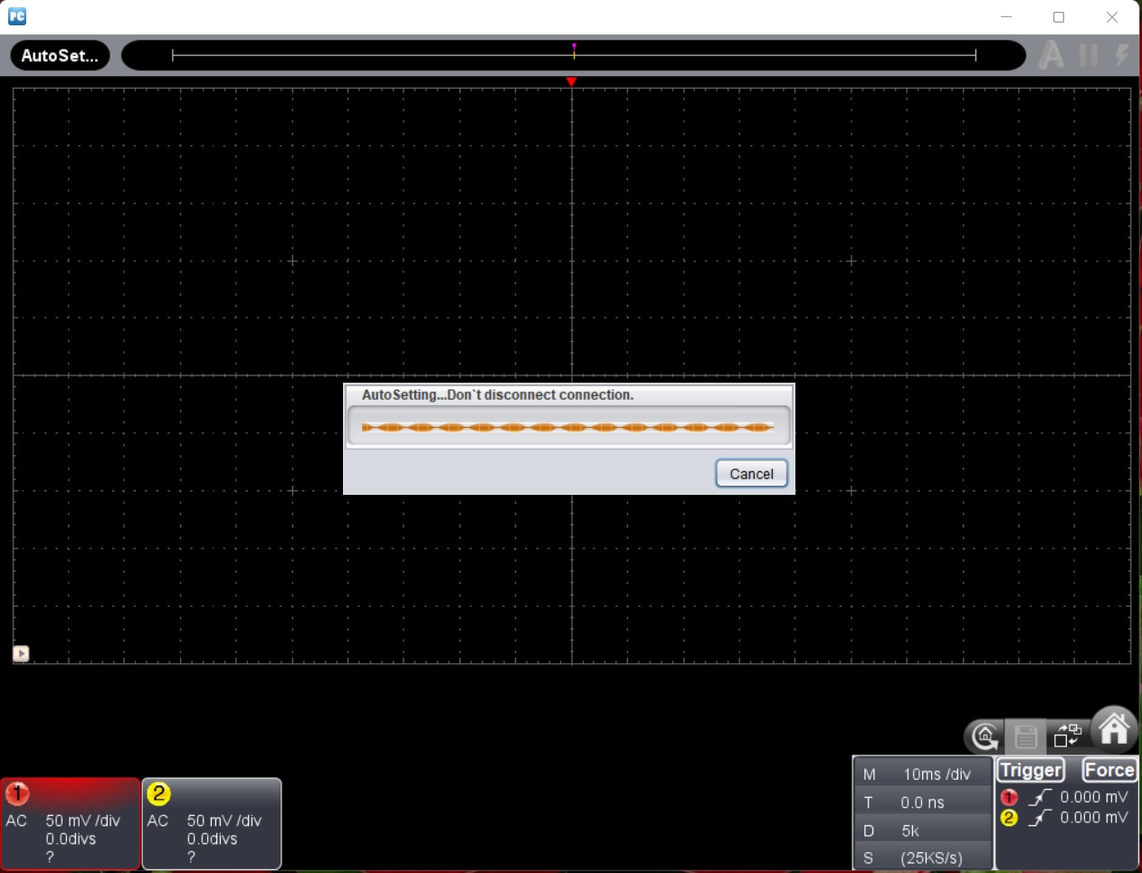

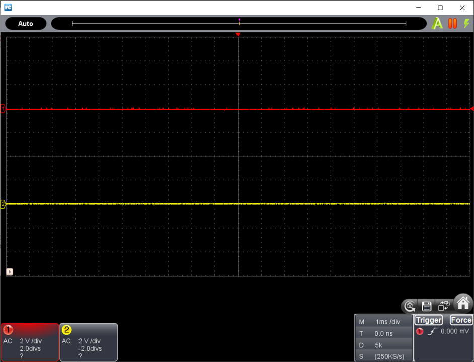

Recently I ordered a PC oscilloscope as the poroject14 prize from 555 timer madness contest. I have always wanted to own a oscilloscope, been trying since 2017 and finally I own one. This is my first ever oscilloscope sore really excited about it!!
But I'm facing troubles getting it to work.
I followed the instructions in the manual, installed the drivers correctly, the USB scope is identified by windows device manager, however when I try to check for waveforms, there's nothing displayed.
As per the manual, I tried to use the probe compensation, and clicked in auto-set to auto set the scope window, however it gets stuck forever at this point as shown in image below.
I tried reconnecting, reinstalling drivers, but nothing seems to work.
Have you used this device before? Any help on how to make this work is appriciated.
UPDATE: The scope's working fine now. I had to install the drivers from Owon website and change the software as well. I'm using the software from Owon. The scope seems to be working fine now.

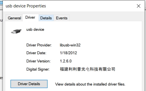

  • baldengineer
    baldengineer over 3 years ago
    Sounds like you either have a hardware or driver problem.
    That's what my MP720016 looks like when the software launches. (With the traces showing noise.)
    That's how the driver appears in Windows 10 device manager.

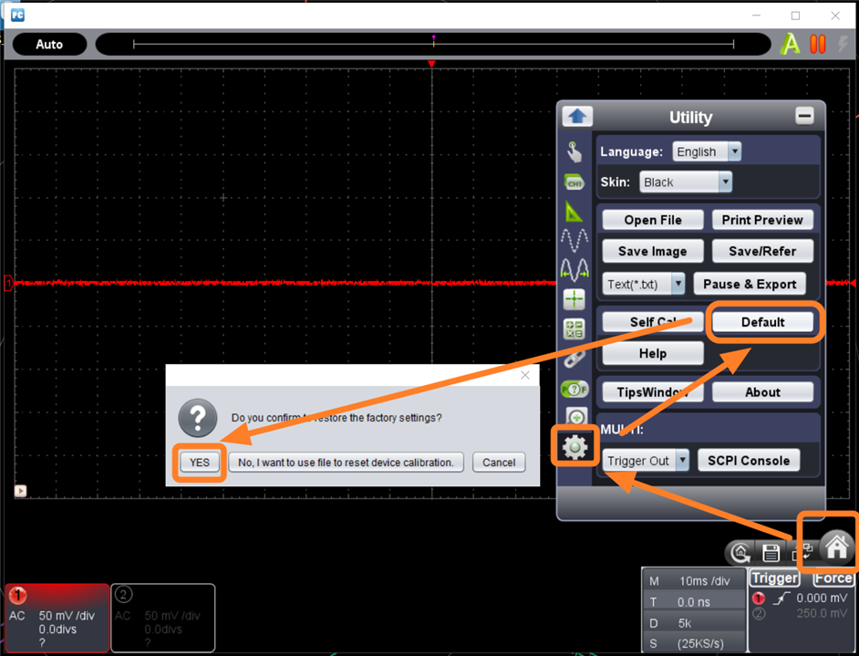

    Note, I have other libusb32 devices (and drivers). DS-Wave (C2, not S2!) didn't like them! I had to use the usb_device.inf that came with the Multicomp software. I installed it through Update Driver -> Browse List -> Have Disk.
    Jan Cumps over 3 years ago in reply to baldengineer
    One thing I see, is that rsjawale24  has trigger active for both channels ...
  • baldengineer
    baldengineer over 3 years ago in reply to Jan Cumps
    Good catch. On my mine, I can set the trigger to "Alternate," which (I guess) alternates between Channel 1 and 2. The UI looks the same as rsjawale24's.
    Auto sweep still updates the display, and Auto-Setup works as expected.
    That said, rsjawale24, you might try doing a default setup:

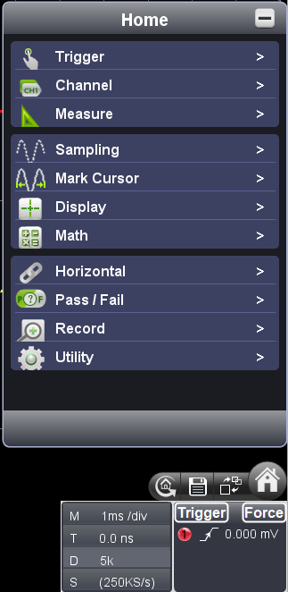

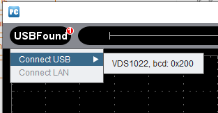

  • ralphjy
    ralphjy over 3 years ago
    I'll have to admit that I haven't had any issues with my installation, but your VDS_C2 app looks a bit different from mine.
    Up in the upper left - the button on yours is AutoSet while mine is Auto.  This is the button to connect/disconnect the app to the scope.  I assume that you are connected.
    If I push the button on mine while connected it gives me the option to disconnect
    If I am disconnected and it can find the scope, it will give me the option to connect (in my case I only have USB connected)

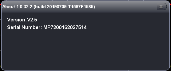

    If you press the "House" icon in the lower right, you can get a Home menu and under Utility -> about you can find your scope/app info.
    Not sure if any of that helps...
  • baldengineer
    baldengineer over 3 years ago in reply to ralphjy
    "Auto Set" is what the indicator in the upper-left hand says after clicking the "Auto Setup" (A icon on the top-right), while the auto-setup routine is running.
