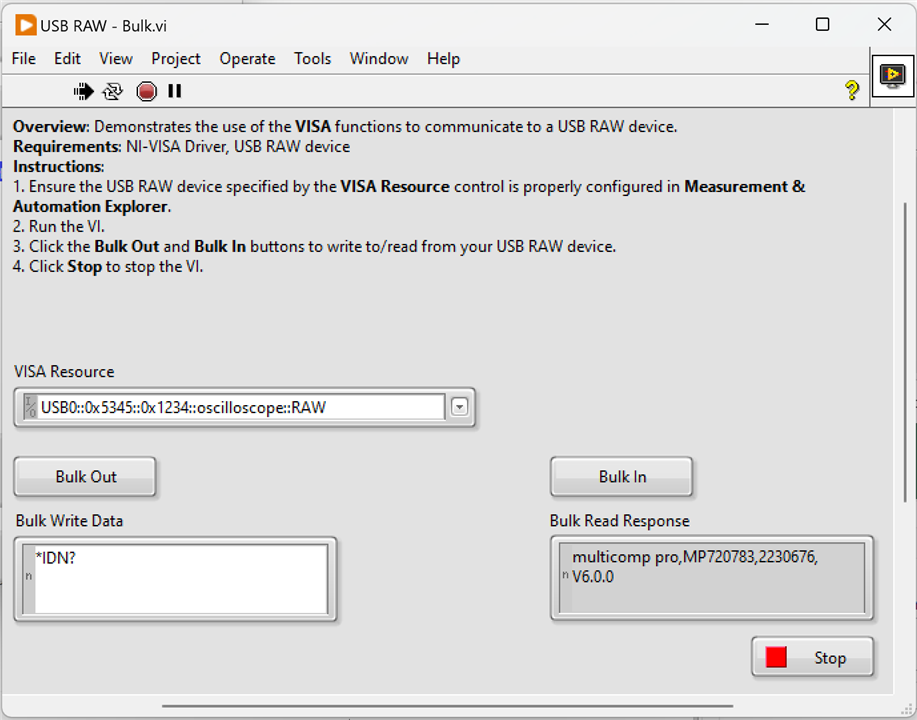

Interface with LabVIEW
You can connect to the instrument as a USB RAW device. You use this URI in the VISA Open block to connect: USB0::0x5345::0x1234::oscilloscope::RAW.
I have generated a NI-Visa USB driver for the instrument, using the NI-VISA Driver Wizard. But I think that's not actually needed. If someone else can test with the default driver that comes with the instrument, that would be great. The advantage of using the self-generated NI-VISA driver is that the instrument pops up as a recognised instrument in all LabVIEW utilities and flow control objects. The Owon PC GUI will not recognise the instrument anymore, but that's a small (and easy to revert)  loss.

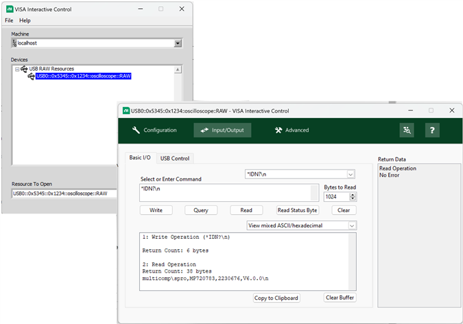

Here are two easy ways to start working with the instrument. You can interact with the VISA Interactive Control utility:

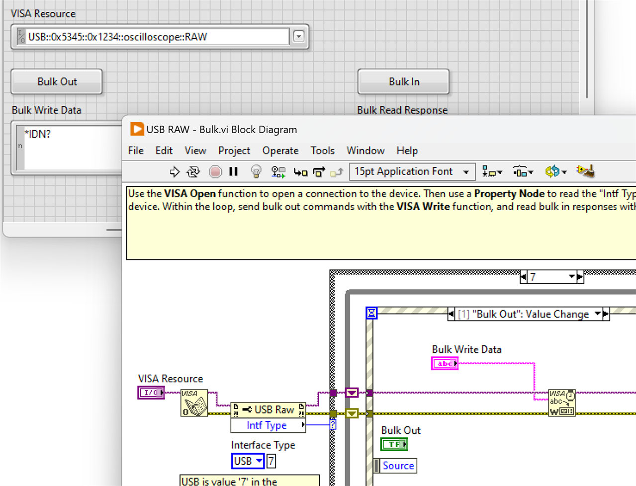

A first real step to creating a control flow, is to load the USB RAW - Bulk example that comes with LabVIEW. This is a flow that will showcase how you interact with the instrument.
