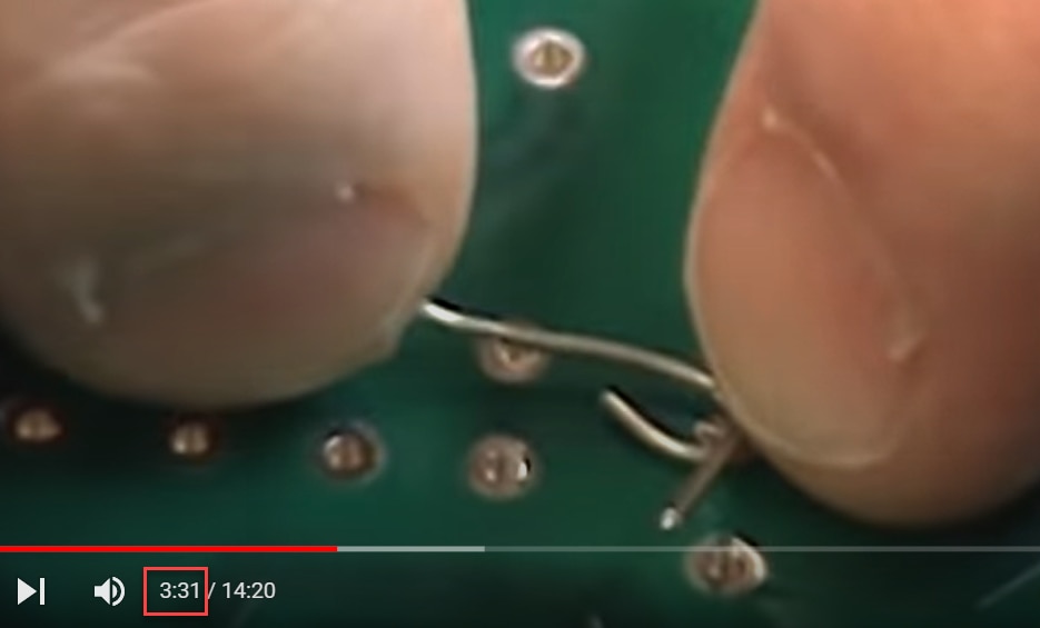

    Jan Cumps over 3 years ago in reply to hlipka
    Well, I claim that he bent the lead more than 30°:

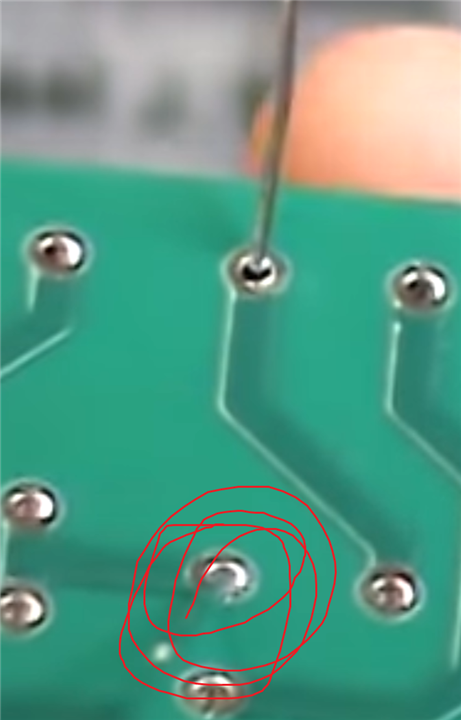

  • ntewinkel
    ntewinkel over 3 years ago in reply to Jan Cumps
    Jan Cumps said:
    the cut end of a lead is exactly the same material as all the rest of the lead. And that's exposed too.
     hlipka ’s video starts by saying the leads have to be tinned too. I’m curious why exposed solder is ok, but exposed leads are not ok Shrug

    shabaz over 3 years ago in reply to hlipka
    I just watched the video. I'm surprised, personally I wouldn't say that my normal soldering practice is all that different, for working at a good speed. I don't think I deviate too much. I don't pre-tin, presumably it is easy for them because they have the solder bath. (I pre-tin stripped wire though, out of habit, regardless if it is solid core or stranded). I eyeball the length of the component leads instead of using that neat trick with the looped component wire, but I trim first just like they do. I form the component leads with pliers, instead of the red tool he used in the video. I certainly don't exceed 30 degrees on PCBs either, because I like the wires mostly straight, instead of combed down (I use blu-tack/putty to temporarily hold the component). (On perfboard when prototyping I will bend and use the component leads as if they were PCB tracks, but that's different). And always clean the board of flux, with this brush (it's very stiff, which works great on PCBs).

    In the good old days of mass production with through hole components we had a machine which cut the component leads after flow soldering.
    It would not have been feasible to machine cut before.
    It was properly set up and didn't cut very close to the board, cutting the excess lead and not the actual soldered joint.
    This was for automotive work (and the boards did get coated, although I don't recall that cut lead ends were ever discussed as a reason for coating.)
