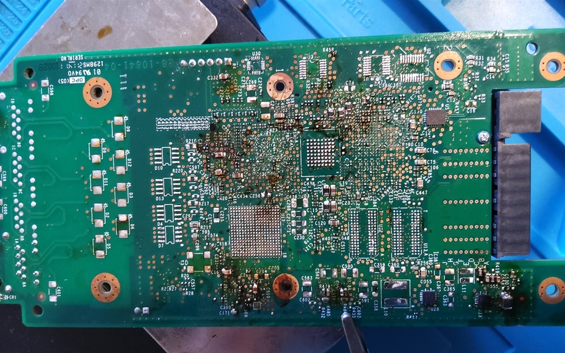

    Meanwhile: this is what my training board looks like. Virtually every component has been removed and replaced several times. With hot air and with irons.
    The darkish parts are areas I've been using the last days with a conical tip. It's not burnt PCB. it's the colour of the flux I use once it's cooled down.

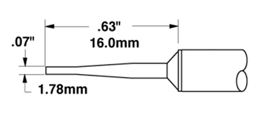

    Interesting, I have never really liked conical tips as the heat transfer is not that good. Since  I am very fortunate to own a Metcal my go-to tip is a "micro-chisel" STTC-142.
