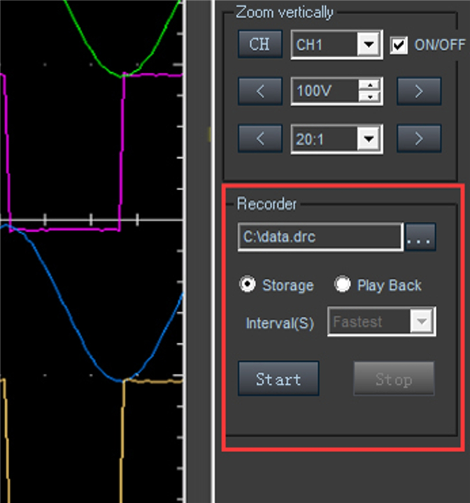

i have a question about HANTEK 1008 :
When I hit the start button in the acquisition mode, according to the time that passes, the number of samples in saved data txt file is 500 .
But this number is always 500 regardless of the running time,
i mean i always have a CSV file with 500 rows of numbers no matter i wait 1 minute or 15 minutes !  ( even if it is 1 sec )
what should i do ?

    shabaz over 3 years ago in reply to mamad
    There are 8 channels, and 4000 divided by 8 is exactly 500, which is what you're seeing. The device has 4k of sample memory. Where do you see the reference to 20000?
    You could try adjusting the interval time in the red box, in case it streams the data indefinitely under some circumstances.

    Regarding the 4000 in the demo mode that you said, each channel gives this number, so there is no need to divide
    Regarding the red box: as you can see, that option is inactive for me and I don't want the drc file ,  it must be CSV so that I can use it in the Excel environment.
