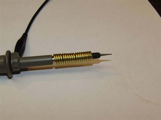

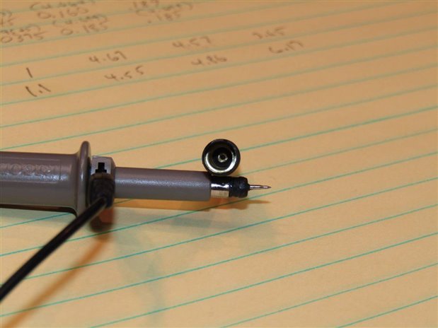

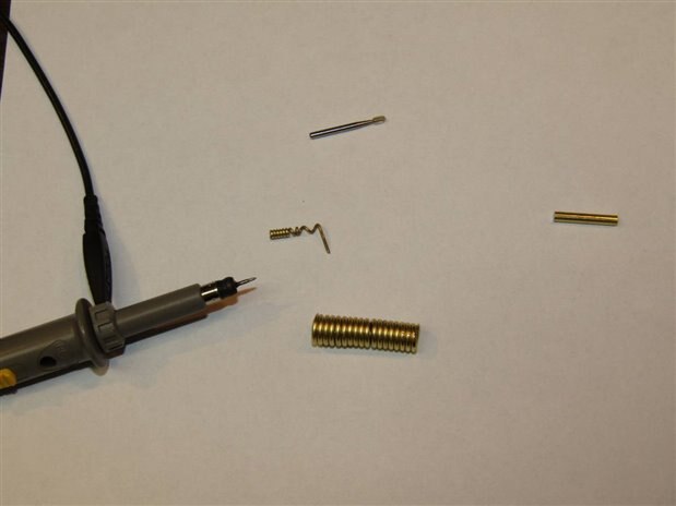

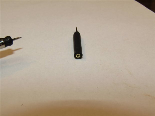

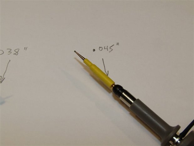

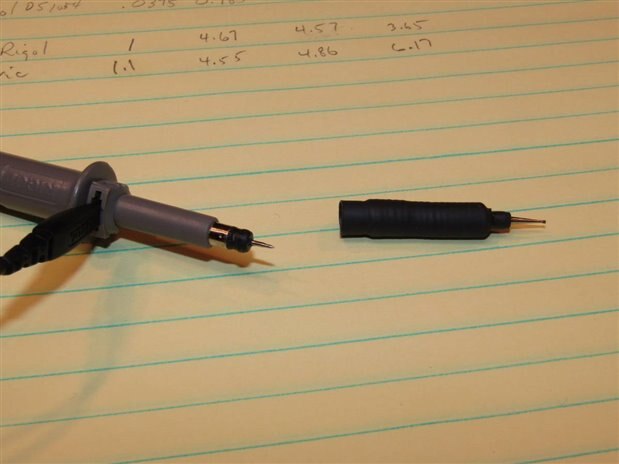

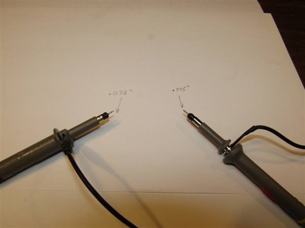

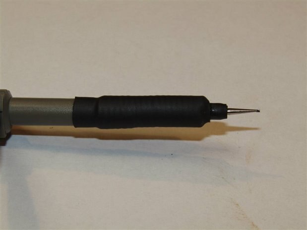

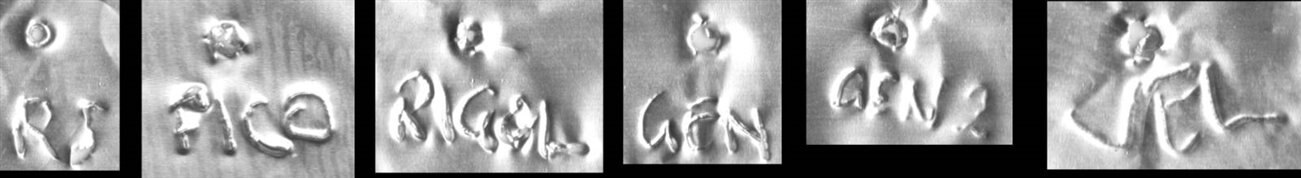

I need some help collecting data about Oscilloscope Probes. I am thinking of making some low frequency Non-Slip probe tip adapters for Oscilloscope probes. With the limited number of Oscilloscope probes with in my reach it does not look like there is any standardization.
As you can see the two probes that I own each have different diameter probe tips. It would help me plan my project if I could find out what the diameter and length of oscilloscope probes from as many of you as possible. Please measure length of the consistent diameter of the tip and also the diameter itself. I can accept measurement in inches or millimeters. Here is what I hope to be able to build without having to custom make each one.
Your help would be appreciated.

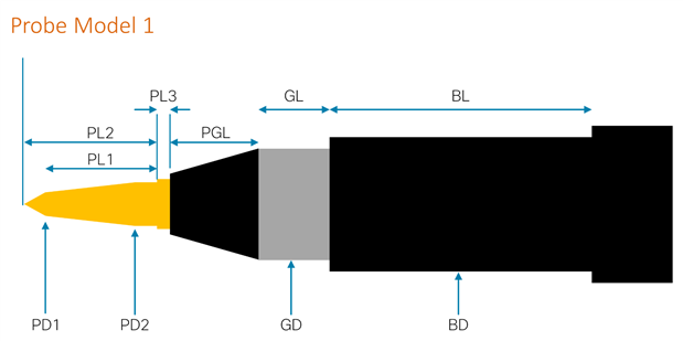

    dougw over 7 years ago in reply to dougw +9
    I have 3 types of probe: pin diameter = PD pin length = PL ground ferule diameter = GD ground ferule length = GL plastic barrel diameter = BD plastic barrel length = BL all dimensions in mm

    jw0752 - I decided to give my improvised method a go - I grabbed a piece of foil and corrugated cardboard, punched the probe tip through the foil into the cardboard and scanned the foil at 4800dpi to judge…

    shabaz over 7 years ago
    Hi John.
    Sorry for the delay on this, I took a look at the probes here, and I wasn't sure what level of detail you needed, so sketched this up, so that we're using the same terminology (I took Doug's naming convention : ):
    For the three probes I have, these are the measurements:
    Tektronix TPP0200TPP0200:
    PD1 = 0.73mm
    PD2 = 1.12mm
    GD = 3.80mm
    BD = 4.93mm
    PL1 = 4.0mm approx
    PL2 = 4.5mm approx
    PL3 = 0.5mm approx
    PGL = 4.5mm approx
    GL = 3.0mm approx
    BL = 20.8mm approx
    Tektronix TPP1000TPP1000:
    PD1 = PD2 = 0.65mm
    GD = 3.85mm
    BD = 4.95mm
    PL1 = 2.0mm approx
    PL2 = 3.5mm approx
    PL3 = 2mm approx
    PGL = 5.0mm approx
    GL = 3.0mm approx
    BL = 14.5mm approx
    Picoscope TA375:
    PD1 = 0.91mm
    PD2 = 1.34mm
    GD = 4.82mm
    BD = 6.20mm
    PL1 = 5.0mm approx
    PL2 = 6.0mm approx
    PL3 = 0.00mm
    PGL = 5.0mm approx
    GL = 3.6mm approx
    BL = 26.0mm approx
