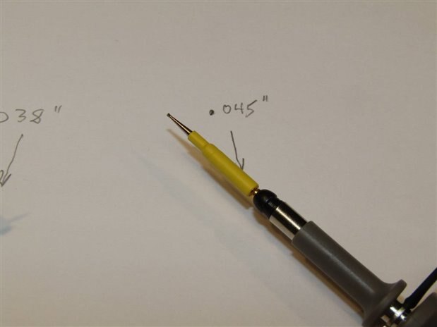

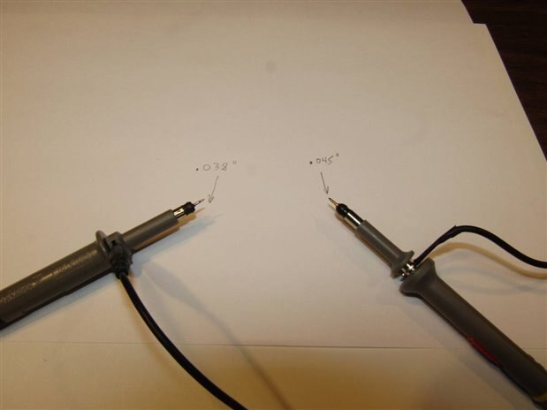

I need some help collecting data about Oscilloscope Probes. I am thinking of making some low frequency Non-Slip probe tip adapters for Oscilloscope probes. With the limited number of Oscilloscope probes with in my reach it does not look like there is any standardization.
As you can see the two probes that I own each have different diameter probe tips. It would help me plan my project if I could find out what the diameter and length of oscilloscope probes from as many of you as possible. Please measure length of the consistent diameter of the tip and also the diameter itself. I can accept measurement in inches or millimeters. Here is what I hope to be able to build without having to custom make each one.
Your help would be appreciated.

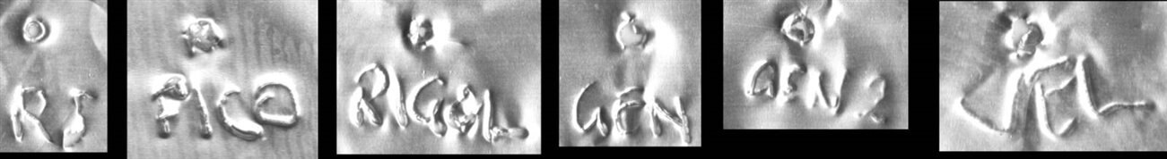

    jw0752 - I decided to give my improvised method a go - I grabbed a piece of foil and corrugated cardboard, punched the probe tip through the foil into the cardboard and scanned the foil at 4800dpi to judge the size of the depression as a way to measure the probe tip diameter.
    My pin diameters measured out to be (using Photoshop to the nearest 0.1mm):
    R&S - 0.5mm
    Rigol - 0.7mm
    Generic #2 - 0.7mm
    Generic #1 - 0.8mm
    Pico - 0.9mm
    Velleman - 1mm
    Of course, I'm not sure how accurate it is, but judging from the R&S RT-ZP10 specs which shows the gold plated spring tip (that I'm using) is 0.5mm, I'd have to say that my measurement mode is likely to be accurate "enough". Sorry, no information on pin length as yet image.

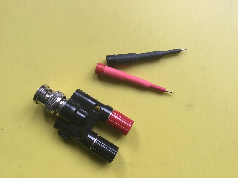

    jw0752, for low frequencies, I use a converter, and then normal DMM probes with your anti-slip points.
    When you build add-ons for oscilloscope probes, there's a whatch out apart from different size of probes:
    the tips are delicate, so the insertion power has to be low and the grip power high enough so that the extension does't cause stress on the probe point.
    • Vote Up +6 Vote Down
