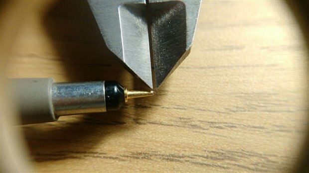

    14rhb over 7 years ago
    Hi John,
    Great series of posts. If I'm not too late I've measured my scope probe (Tektronix P6109B) for you; although it is quite old like me.
    The tapered section of this probe measures 1.24mm diameter at the base to 0.89mm diameter just before the 45 degree chamfer starts. The collar before the insulating black section is 2.39mm diameter. The chamfer section is 0.49mm long (as being measured in photo).
    Rod
