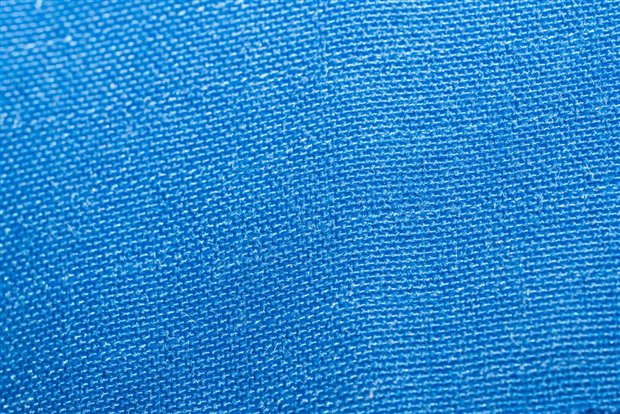

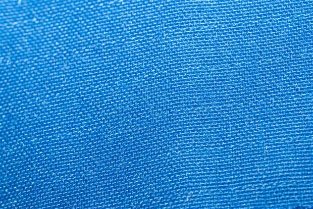

    Just out of interest I attempted a lab coat as well, given that it is supposed to be for ESD-safe environment. I think I can just about see some difference in the weaving, but I could be imagining it - I think I see faint rows of single strand of maybe conductiveness, about 5mm apart (horizontal strands in the photo below, about six of them across the photo). But I cannot measure the resistance no matter how hard I try with the positioning of the multimeter leads - also tried the insulation tester. The strands are so fine, I can't get contact with them.. I suppose I could soak two sections of the lab coat and place the probes there! Regarding strands, I don't think the entire surface needs to be conductive anyway. As I understand lots of static discharging can be (say) having a conductive brush very close to a surface. At least it works in my limited experiments.. if I wipe some plastic against some cloth to put on a charge, I can pick up tissue-paper fragments. But if I move a conductive brush close to the surface of the plastic (i.e. close but not touching the surface, and the brush is grounded via me), then the plastic is no longer charged and it cannot pick up bits of tissue paper.
