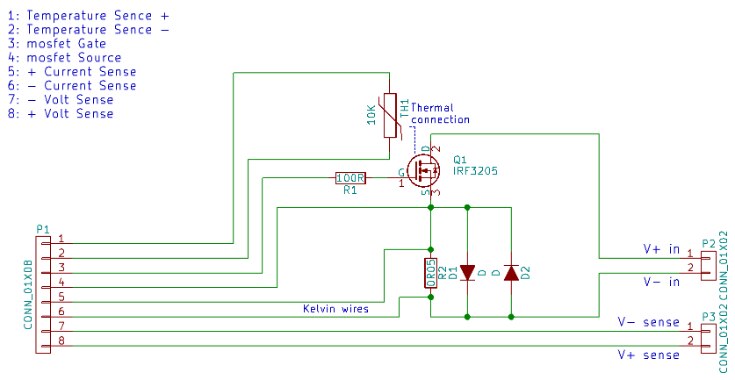

This blog documents focuses on the power stage of the electronic load that Robert Peter Oakes, jc2048 and Jan Cumps are designing.
In this post we're laying out a PCB for the power stage - as much as possible with surface mount components. The FET is close to the one Robert Peter Oakes uses in the original design.

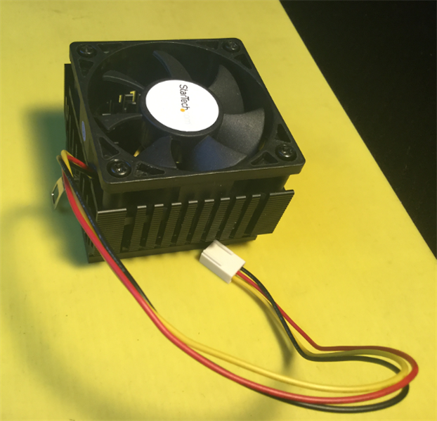

Cooler HeatsinkStartech.com FAN370PRO - Socket 7/370 CPU Cooler Heatsink and Fan

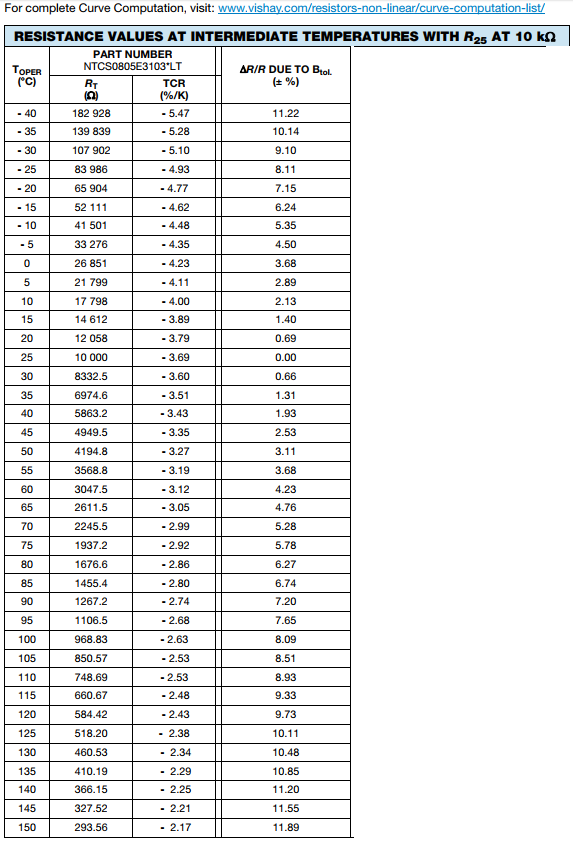

NTC
For a detailed description on the temperature protection mechanism, check Programmable Electronic Load - Temperature Protection.
The voltage sent to the ADC is very dependent on the NTC. I've selected a Vishay NTCS0805E3103JLTVishay NTCS0805E3103JLT -  THERMISTOR, 10K, 5%, SMD, NTC.
I'll program the key values. The behaviour is non-linear and it's easier to make a lookup table if the firmware has to be able to deal with different components.
This will require access to flash to permanently store tha values, and a SCPI function to alter the table if another component is used.
For the first version I'm going to be selfish and just program for the device that I've ordered.

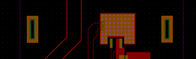

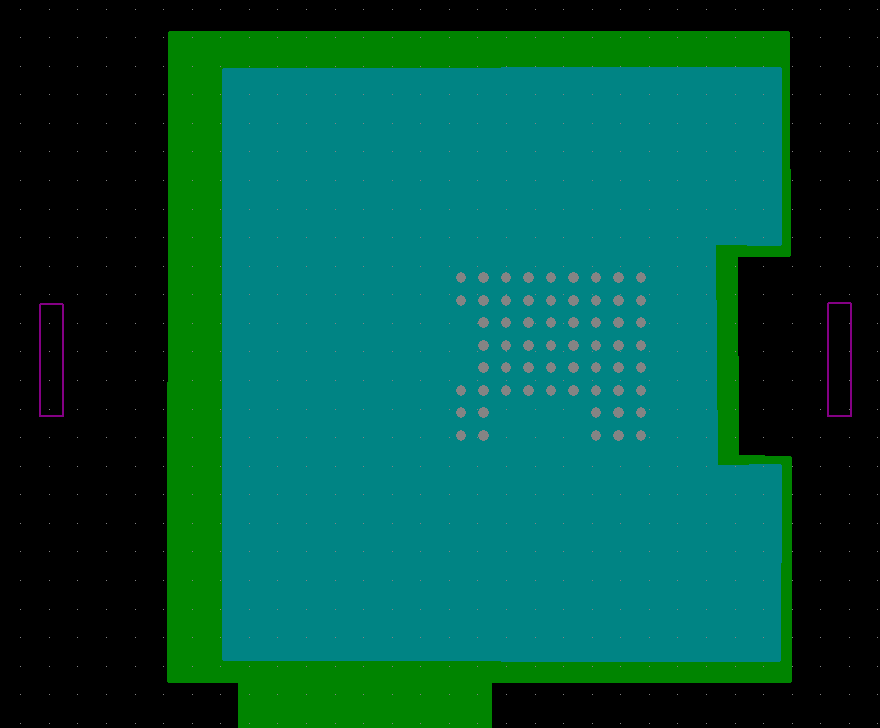

PCB

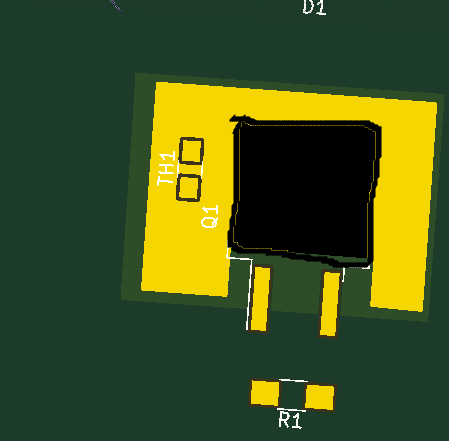

Exposed copper
For good thermal relief, and to get the NTC as good termally coupled to the FET as possible,
I placed a copper pour (here on the front, I'll do the same on the back and stitch them for thermal transport with vias)
Then i drew a pour on the front mask. The area of pour will expose copper. That means that the NTC has physical contact with the copper that the FET is soldered on.
In the fine-tuning I will place that NTC closer to the FET so that I can put a tad of heat paste in between. Or I could put a tad of paste between the NTC and exposed copper ...
Attention when placing the binding posts. For the power input, RED is 1 and BLACK is 2.
For the sense input, BLACK is 1 and RED is 2.
This is the result of me labeling pin 7 and 8 of the connectors between the driver board and FET board wrong, on both boards image.
The documentation and KiCAD zips are now updated with corrected schematics.

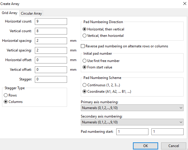

I used these 2 Contextual Electronics videos to refresh how to expose copper layers and place VIA arrays:

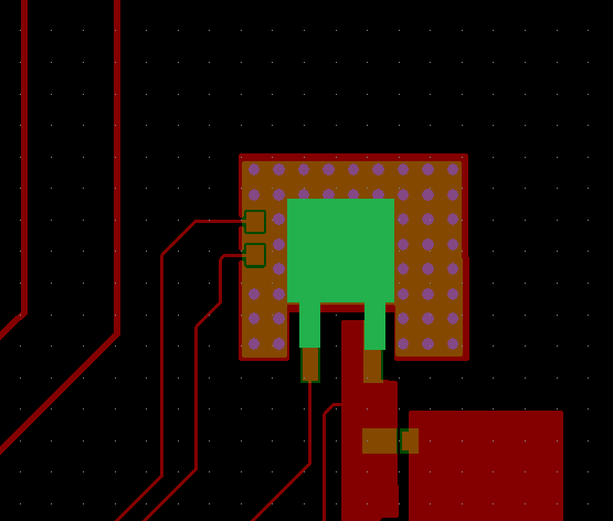

Here's the top side of the completed design. I've drawn the FET in green to give perspective.
In red you see the copper layer, orange is where the solder mask is removed and copper exposed.
Pink are the drill holes. They are 0.9652 mm, in an array of 9 * 8, spaced 2 mm apart.
On the bottom, the copper pad (green) has the size of my heat sink + some. The removed mask (blue) has the exact size of the sink's bottom profile.
The pink lines are the mounting slots for the heat sink (see below).
Slots
My heat sink has brackets for mounting. I've cut out slots to allow the brackets to through the PCB and fix them on the top side.
I've put some exposed non-connected copper pour around the slots for strength.
The slot is drawn on the Edge.Cuts layer. I hope that the PCB fab interprets that as slots to be milled out ...

    PCBs have arrived from Seeed. The heatsink fits perfect on the pad. The slots for the mounting bracket turned out OK.

    I'm not very impressed with my own heat dissipation design, michaelkellett. I'm not far off from the document you referred too. Still, my FET runs hot.
    I've got the stitches between front side and back side of the PCB filled with solder, and my fan-cooled heat sink on the backside has a full contact with the PCB's backside.
    The heat sink is cold to the touch - lower than room temperature. The FET on the other side runs uncomfortably hot.
