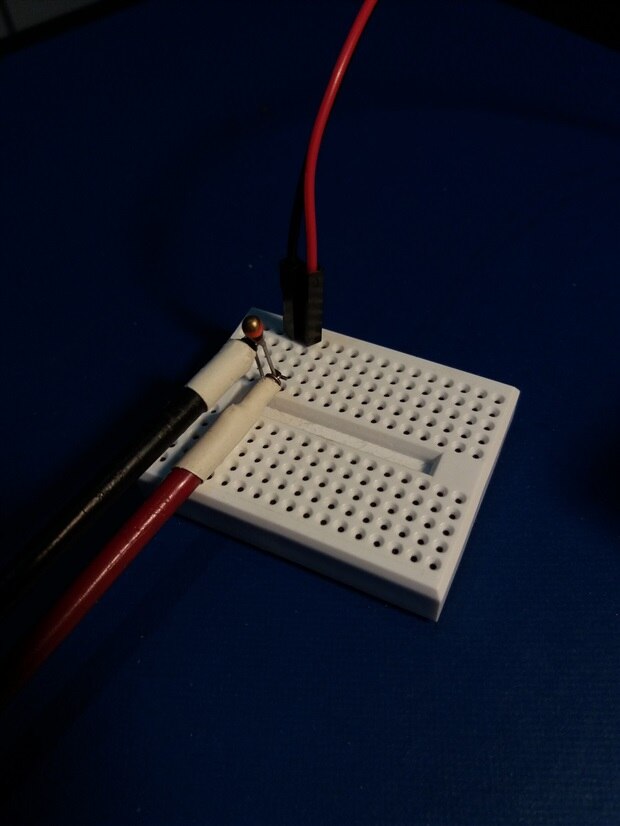

The first exercise is to find the right Temperature vs Resistance table for the NTC I'm using.
In this article I use a Vishay NTCLE100E3103J. That's a different component than the one in the final design.
There are two reasons:
  • I have this one available for testing and it's through-hole. That makes prototyping easier
  • Our final design doesn't prescribe the NTC to be used. The characteristics can be programmed and saved in FLASH (if all works out).
    It's good to have two different components to validate that this flexibility works.

The component we're using for testing is a Vishay NTCLE100E3103NTCLE100E3103. If you want to follow along, click on the product link to get the datasheet.
It's a 10K thermistor with a negative temperature coefficient, 5% tolerance, Beta 3977 K.

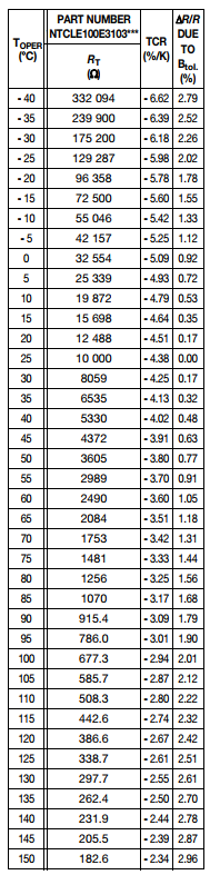

The datasheet specifies the calculations that can be used to calculate resistance for a certain temperature. I can use them in the firmware - they apply for many NTCs of the same make.
In that case, the configuration would require a few parameters and temperature can be derived from that.
In this design I'm implementing something simpler, based on lookup values. Most datasheets contain a table that lays out resistance vs temperature.
Here is the one for the device I'm using in this blog (again: different than the final design (from the datasheet linked above, page 10).
We're not building a thermometer. We're not interested in how warm the FET exactly is (ok, maybe you are. In that case you can use a SCPI command to get the voltage at the NTC and derive the exact temperature image ).
What we want to know is if we're operating in the FET's comfort zone, if it's still safe to touch, if we're running hot, near critical and over-temperature.

With the example of the NTC data sheet table above, to make the device switch off at 125° C, you'd enter:
CALibration:TEMPERATUREMAXResistance 339
For the NTC that's suggested in this build, the command to switch off at 125° C is:
CALibration:TEMPERATUREMAXResistance 518
