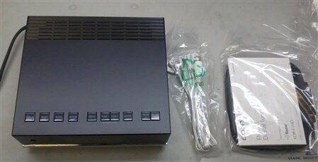

A few weeks ago when I started researching HD Radio, I found that there are few high-quality receivers.   I asked Jessica Crotty of C. Crane, a high-end radio retailer, which radio they recommended.  The answer was none of them.  They tested many of them, and they couldn't find any that had good AM performance.  The only one they liked was Sony XDR-F1HD, which is discontinued.  image

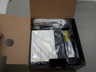

I had not planned to revisit HD radio again, but someone lent me a Sony XDR-F1HD, so I decided to test it to see how good HD can get.  I compared it to the Insignia NS-HDRAD and an ICF-2010.
XDR-F1HD is a receiver only with line-level audio output.  I does not have an amplified output for headphones or a loudspeaker.  It comes with a dipole antenna for FM and a loop for AM.

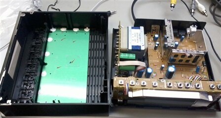

Under the Hood

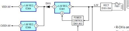

The heatsink on the right is connected to a 3.3V linear regulator.  The linear drives 1.8V linear regulators that supply power to the tuner and the baseband digital module, the two modules in cans. I would love to know if they used two linears in series to filter noise or for some other reason.
The board on the top of the enclosure (on the left side of the picture above) has no parts on it.  It appears to be a stiffener.
The boards have mask and copper etch on one side only.  They use jumpers for “solder-side” connections.  This cannot have saved that much money.  You’d think the added cost of the jumpers would outweigh savings from omitting copper and mask from one side.
