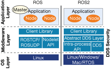

The differences between ROS 1 and ROS 2 fall into three main categories: Architecture, Features, and Tooling/Ecosystem. The following are the main differences:
  • Architecture: ROS 1 uses the ROS Controller-Node Architecture and XML-RPC middleware. In contrast, ROS 2 uses DDS for higher efficiency, reliability, low latency, scalability, and configurable quality of service (QoS) parameters. While XMLRPC is suitable for simple remote procedure calls, DDS supports real-time systems and removes communications from single points of failure.
  • Backward Compatibility: ROS 2 is not backward compatible with ROS 1, meaning that ROS 1 packages may not work with ROS 2 without some reworking. However, tools like ROSbridge can simplify the transition.
  • Communication: ROS 2 utilizes industry standard communication methods that are widely deployed in industrial applications. These include IDL (Interface Definition Language), DDS, and DDS-I RTPS (DDS Interoperability Wire Protocol - Real-Time Publish Subscribe Protocol). Its use of DDS and DDS allows for superior real-time processing, especially when deterministic, low-latency communication is needed.
  • Libraries: ROS 1 has two separate libraries, roscpp for C++ and rospy for Python, which have a gap in feature-parity. ROS 2 has a base library, rcl (ROS client library), written in C. Libraries are built on top, ensuring core functionality is available in different APIs. This allows ROS2 to offer language support for additional languages, such as Java and C#.
  • Licensing: ROS 2 code is licensed under the Apache 2.0 License, while ROS 1 code is ported under the 3-clause BSD License. Both licenses permit use of the software without affecting the user's intellectual property.
  • Message Data: In ROS 1, message data is stored in the bag file format, created by tools such as rosbag. In ROS 2, rosbag provides more serialization flexibility than with ROS.
  • Operating Systems: ROS 1 was primarily built for Ubuntu, while ROS 2 runs on various operating systems, including Linux, Windows, and macOS.
  • Tooling changes: Tooling changes between ROS 1 and ROS 2 include the replacement of Catkin with Ament as a build system, and overlays, a secondary workspace that you can customize without affecting the primary workspace.
diagram 4
Figure 4: A Comparison of ROS 1 and ROS 2. Source: Researchgate.net
ROS 1 and ROS 2 have some additional differences. As illustrated in Figure 4, ROS 2 uses a peer-2-peer protocol, while ROS is a controller-node protocol. With ROS, parameters describe the configuration of nodes. In ROS 1, a parameter server controls the parameters, however, there is no global parameter server in ROS 2. Each parameter is specific to a node. Services in ROS 1 are synchronous, meaning requests are stuck until the server responds or fails. In contrast, ROS 2 uses asynchronous services. Actions were never part of the core functionalities in ROS 1 but were added to address the lack of asynchronous services and feedback mechanisms.
