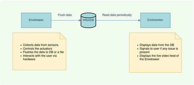

Architecture overview
The good thing about writing such an architecture is that you can write it independently of most other things. The one limiting factor in this case was the choice of frameworks and our communication method. In the picture below you can see the high level overview of the software elements of our project.
Envidrawer script, Envimonitor and an InfluxDB constitute the Envidrawer project
We will talk through each element of the software elaborating where required. Feel free to ask if anything is unclear or something is not too clear or the code not self-explanatory (should be though :)).

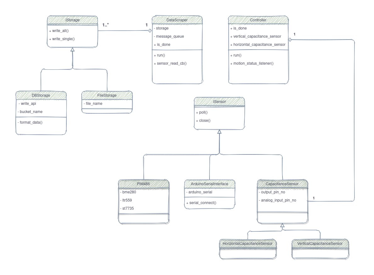

But enough of the environment setup, time to show the most important picture for this part - the class diagram. Lo and behold:
In it you can see that we have two main objects whose purposes are:
Scraper - subscribe to messages from sensors and group the data to flush them periodically when the poll method is called (when the time is right!)
Controller - subscribe to messages from sensors and perform actuation of DC motors if particular conditions are met
Apart from them, each sensor or a sensor group implements an ISensor interface (implements methods defined by this interface) and is created in the main loop for easy access. Depending on the sensor, different logic is performed and different messages are submitted by them. Sensors are registered and created in the main loop for easy access and are periodically probed for data which is stored in the Data Scraper for later collection.
Above you can see an example of such a sensor. Most of them perform data communication in the poll method synchronously.
In order to facilitate implementation the data structure which is used for this message passing should be consistent and general. Hence the SensorData structure is used throughout the Envidrawer application for communication.
In a low-level language it would have to be properly structured with some enumerations or bitflags to utilize memory more efficiently (it has to be copied around and not moved in most cases...), however this is python and we can get away with strings and other heavy data structures in it. Each field is mostly self-explanatory, the sensor group field was added for Pimoroni Hats sensor grouping and the time field was added for accurate logging of the data in time.
With such a handy data structure, saving the sensor values to the DB is but a cinch. I will later present how InfluxDB stores this data as it is a time-series DB. For now rest assured that this preparation is not just a fad:
The remaining classes in the preceding diagram are storage classes. I decided to yet again make use of an interface and implement both FileStorage and DBStorage. In these classes the proper serialization (for FileStorage) and DB saving is done. The data is formatted properly and flushed.

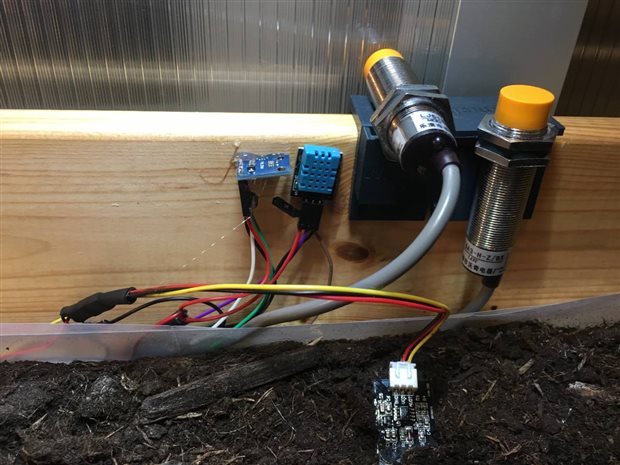

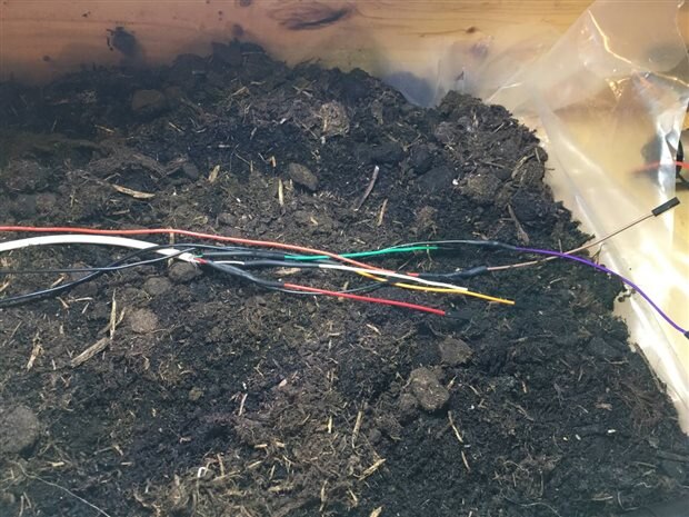

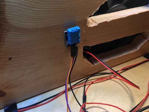

Due to shortage of analog pins on the Raspberry Pi (such a pity) and no multi-channel ADC's on hand we decided to make use of an Arduino Nano Micro as our interface between the sensors and the application. It can be seen in the UML diagram above as ArduinoSerialInterface class. In there we simply pass the messages in an ASCII format and pack them in our SensorData objects which we then serialize to the DB.
Moreover, we connected some sensors and made several tidy cables reusing old wires we found laying around and asking for a second life. Envidrawer, more benefit every day image
Humidity, temperature and luminosity sensors next to capacitance sensor and soil moisture sensor
A lonely humidity and temperature sensor
Cables reused and nicely sleeved with heat-shrink tubes
