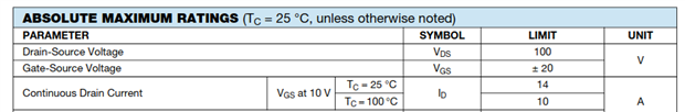

I looked through its datasheet and found that indeed drain current is quite big (14 A at 25 degrees) and Vds up to 100 V. Moreover, for a layman such as me the VGS(th) (Gate-Source Threshold Voltage) being between 2 and 4 V seemed ok for me (taking for granted knowledge from SO answer).

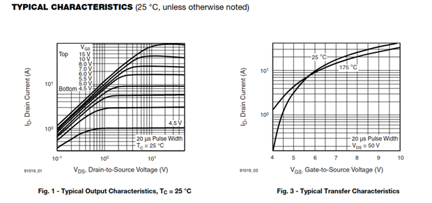

So what went wrong? Let's take a look at a datasheet here:
We can see that the Drain to Source voltage can be up to 100 V (we need only 12 V) and Gate Source voltage can be up to +- 20 V (also OK for our application - 3.3 V), the drain current will be maximum of 6 A for two LED strips in parallel.
As you can see, the VGS(th) is specified with a drain current - Id of 250 uA, and taking a look at the graph below we can see that there is no current rating for VGS lower than 4 V meaning the manufacturer does not guarantee that the MOSFET will be ON with voltages lower than 4 V.
Indeed, the transistor did not turn ON and my LEDs remained turned OFF (because there was no current going through them). This is what you get for not using logic level transistors!

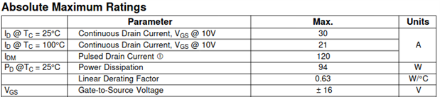

Thankfully, we had IRL540N laying around as a long-past present kit of spare components, which came in handy right now image We replaced the MOSFET with the logic-level one (having a VGS(th) of 1 to 2 V) and the circuit sparked to life!
Datasheet of IRL540N for comparison:
VIDEO
As can be seen, the VGS(th) is now much below the TTL HIGH level, making it fully turned ON for our GPIO '1'!
Comparing two MOSFET curves we can now see that in case of IRF530N the VGS is not even considered on this scale to be below 4 V and for the logic level one it is drawn up to 2 V (which is maximum VGS(th)) and even at this level the IDS (Drain to Source current is of 1 Amp).
IRF530N
IRL540N

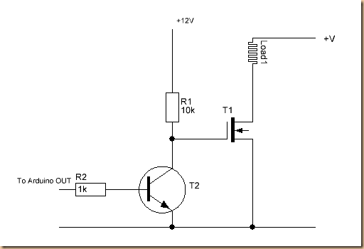

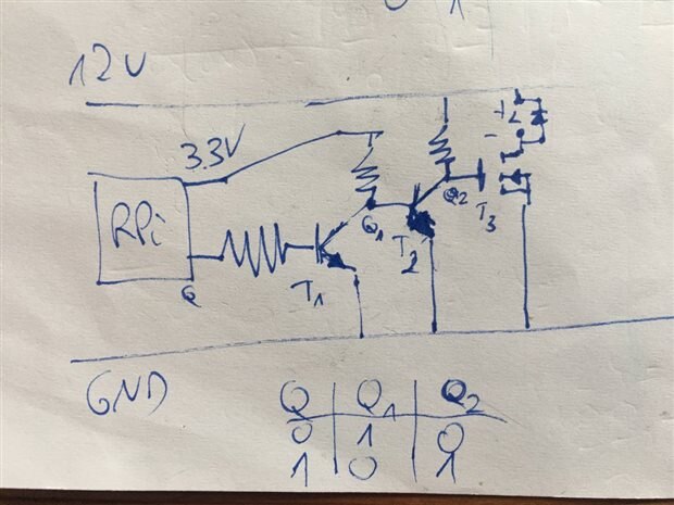

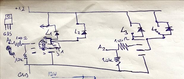

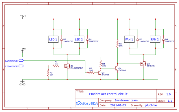

Okay, fine, we have our LEDs or Fans powered but not both of them, so what now? Of course, we could connect them all in parallel and be done with it, but our requirement is to have two separate control circuits for that. But because our only power MOSFETs are non-logic level, we have to be creative and utilize some kind of different logic-level control circuitry for that. Does BJT sound familiar? Because following advice from this post, we decided to utilize one just for this purpose.
In the schematic above all is fine, except the transistor acts as a logic inverter (essentially an NOT logic gate). Therefore we decided to do a well-known double inverter in case a programmer who has no idea of how electronics work would not be surprised by our reverse logic behavior. This is visible in the schematics below:
The BJT double logic inversion circuit.
Initial sketch for the wrongly assumed IRF530N with proper resistor values
Final circuit schematic with proper BJT control
The BJT used here is an 2N3904 which is an NPN with a base current much above the source current of the Raspberry GPIO. The first transistor's emitter is connected to the 3.3 V in order not to fry the second one's base. The second transistor acts as the MOSFETs gate activator and is tied up to 12 V.
Configurations of BJT and MOSFETs are very well explained in this article

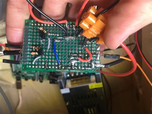

A small quirk of this configuration came to life once I disconnected Raspberry (testing another cable which was stripped for DC-DC step down connection). The LEDs which are connected to the non-logic level MOSFETs sparked to life. This is the result of the 12 V input to the MOSFET which pulls it high (because there is no 3.3 V applied to the second BJT to activate it effectively making all the current flow through this BJT instead of activating the Gate of MOSFET). Sounds complex, I know. Take a look at the first sketch above with the truth table and markings and it will all be clear. This is visible in the video below.

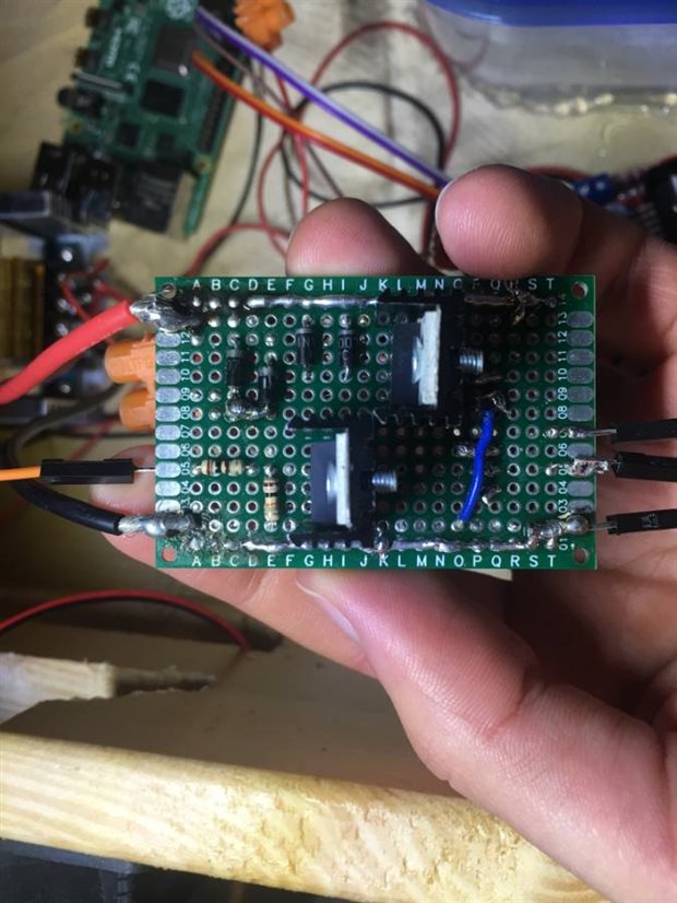

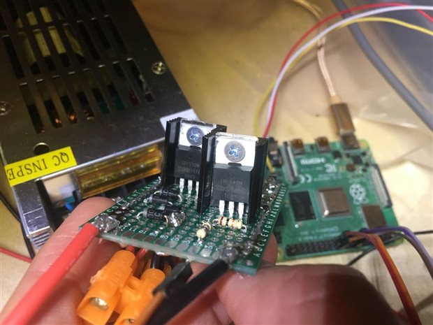

Behold my first fairly complicated (at least for me) circuit soldered on an universal PCB. Some solder joints are not the prettiest (especially that I forgot about nice jumper cables I bought just for that occasion image). The solder bridges were a pain and I found out that doing them is quite expensive but is probably quite handy for rails in circuits.
Front side of the PCB, GND on the bottom +12 V on the top, left side is connected to the logic level MOSFET, right to the power one. Flywheel diodes are visible on this side.
The back side of the PCB with transistors and some jumper cables, as well as connections to the loads (orange cubes).
A different view of the PCB with two MOSFETs protruding proudly
Details matter
In the circuit drawn above some details are present which are crucial in order to prevent failures of the load or microcontroller. One of them is the flyback diode which is used to prevent a huge voltage spike going across the inductive load once the supply current is turned off. This allows for a gradual voltage reduction when the voltage is dropped across the diode. This article contains good description of this.
Usage of resistors is also important and was well explained in yet another article by BaldEngineer (gosh I am not related to them in any way image), basically the resistor tied to the "upper" part of the transistor be it Drain or Collector, serves as a voltage divider with the load, and the one tied to the "middle" part (either Gate or Base) is the one responsible for protecting the GPIO pin from so called "rush" current which is due to the non-ideal nature of the semiconductor devices. Speaking plainly - there is a small capacitor and inductor hidden in our small neat transistor which can do some harm to fragile digital circuitry.
The R2 in the schematic above, is responsible for pulling down the MOSFET's value when the microcontroller is in a reset state and its pins are floating.
Moreover, we decided to stick a heatsink on the IRF530N even though the loads on it are below the maximum rated ones. This allows for more stability and to reuse the board in future projects and helps us sleep well at night. I found a helpful site while doing research on power resistance and whether this MOSFET would require a heatsink for our loads and voltages. Better be safe than sorry!

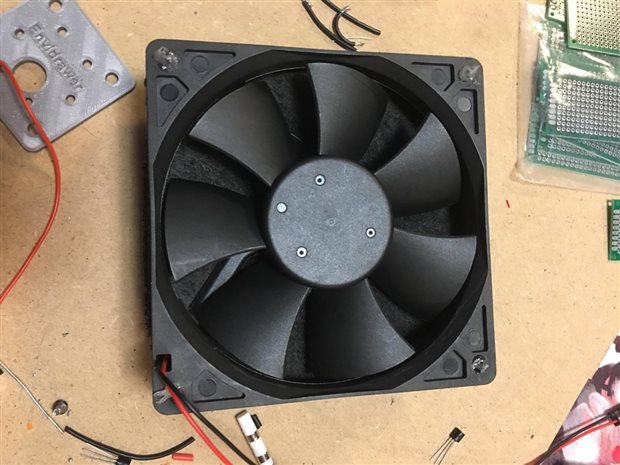

Since we would like to PWM the fans (they are terribly loud when at full speed image), we needed to do some research on the topic and yet again found quite a source of information. This post explained various ways to control a PC fan, be it 2,3 or 4 pin. Because our fan is only 2-pin we decided to do a low-frequency PWM with the logic MOSFET IRL540N. If we wanted to do the PWM at higher frequency (as is often the case with some precision circuitry like PC's or CNC machines) we would need an additional capacitor and a resistor to form a simple RC Lowpass filter. BaldEngineer goes at length to descibe it here. Right now, as I have been testing whether the PWM works I found out it does not work as expected, at voltage around 11.5 V (duty cycle 95%) the fans' engines stall and when the duty cycle is set to 100 they get 12 V and are terribly loud. Looking at the article I linked above (from Analog Devices) it looks like most fans should be still spinning at lower voltage, but this one refuses to work and has a really high stall voltage... This has to be fixed!
WARNING

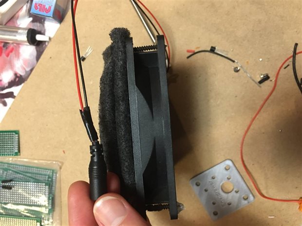

During development of this circuit we had a small fire as one of the pins spontaneously burst in flames and produced quite a bit of smoke (which was quickly removed with the help of our fumes extractor).
This extractor is a simple PC fan with a double carbon-filter layer applied to the back side.
We soldered a nice ending from the LED strip and use it with the power supply that came with one of the 5m LED strips.
It is important to underline that working with 12 V is not as safe as with 3.3 or 5 V. It is not the high voltage that will do the harm, but the quickly accumulating power due to high voltage and current (as was demonstrated with the burning cable). Remember P = V x I or R x I, and taking into account the tiny jumper cable's low diameter size the resistance was quite big. So, the culprit for the small fire was most probably the large heat dissipation due to high resistance.
