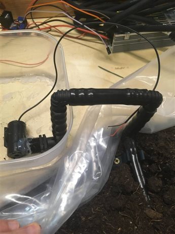

The pipe was buried, sealed and attached to a series of knee connectors. These enter a 1.8 liter box as we decided against using large volume 3D printed one due to material cost and prototype character of our project. The connection is shown on the picture below, with the submersible water pump attached to the bottom of the container using hot glue. All connections were also sealed using hot glue.
Picture 1&2: Submersible pump attached inside the 1.8 liter box and the contraption covered with a lid for protection against spillage
Water distributes evenly, reaching the furthest drippers and cables, as well as properly dispersing in proximal tubules. It is important to notice that the needle-sized holes were big enough for dripping water and humidifying the soil around them. Pump is sufficient for our needs, and can be further regulated with voltage.

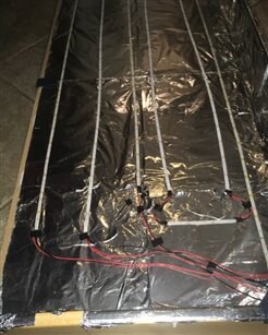

As our last growth turned out leggy and fragile, we needed to improve the lightning inside the envidrawer. We added 5 m of 5W LEDs, of the same temperature and specifications as before, resulting in a total of 10 m of LED. It should be sufficient to prevent such problems in the future. LEDs were placed in a circular pattern on the top of the drawer. They were cut and joined together for balanced light distribution.
Picture 5&6: 2 LED stripes in a circular pattern with separate power line attachment, aluminum foil for reflection of light trapped inside the drawer
