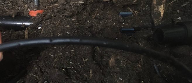

The main tube is 16 mm in diameter and 140 cm in length. This comes to around 1.2 liters in volume. There are 18 drippers in total attached in pairs every 13.3 cm, that give off 2 liters of water per hour each. A short (10 cm) piece of 3mm tubing is attached to each dripper and ran horizontally in the ground.
Picture 1: Piece of the main tube with its terminal seal and 4 last branching out 3mm tubes at the end

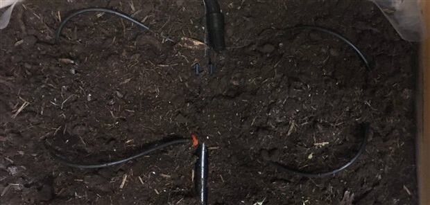

Each one of these tubes was pierced 20 times with a thick needle and the end was sealed using hot glue.
Picture 2&3: Seal at the end of the 3mm black tubes and wide holes in the tube
This allows us for slow and even distribution of water across the Envidrawer.

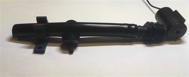

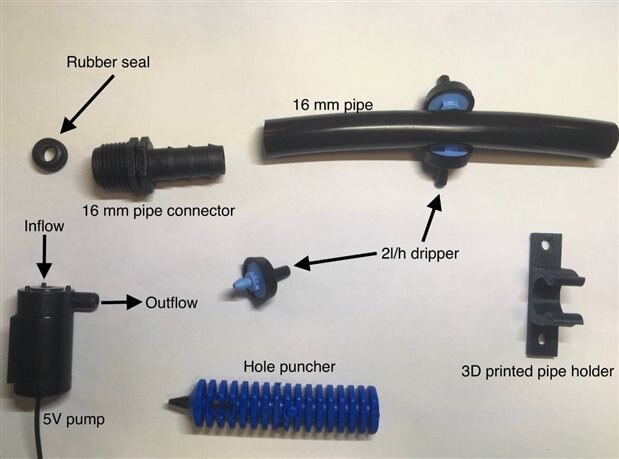

The container is being designed and printed at the moment. It is supposed to fit inside the tight space of Envidrawer and accommodate electronics thus it cannot be installed right away. Inside, a 5V submersible water pump will be installed. We will need to isolate the pump cable from the water container - it will be left out of the submersed part and encased separately to prevent accidental water leaks and spillage.
Water pump and tubing attachment is designed using original parts of the water supply system as well as custom seals and 3D printed components.
Picture 4&5: Model of water connection and described elements of the system including the hole puncher for dripper montage
