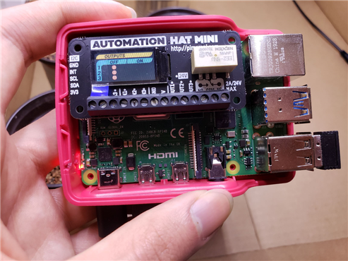

Automation HAT Setup
The Automation HAT is an attachment that perfectly snaps onto the Pi pins. It is outfitted with inputs and outputs that allow automation.

Same as with the Enviro HAT, I power off the Pi before attaching the Automation HAT onto the Pi pins.

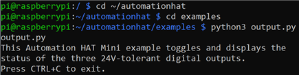

Starting from where I left off on SSH connection, I install the Automation Python library provided by Pimoroni. Following the instructions outlined by Pimoroni's Getting Started with Automation HAT blog, I type the following into the Windows Command Prompt:
curl https://get.pimoroni.com/automationhat | bash
I got a "cannot create directory" error, which means 'automationhat' folder was not created.
I tried using root permissions to circumvent the error. I wrote the following into the Windows Command Prompt to create the 'automationhat' folder and reinstalled the Automation Python library.
sudo mkdir /home/pi/Pimoroni/automationhat
I got the following message, but when I checked the folder, it was empty.
I decided it would be faster copying and pasting the relevant files manually,
Now I have verified that the Automation HAT is working.

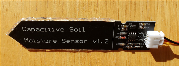

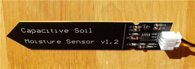

Here's a close-up of the capacitive sensor. As we can see, the edges are exposed. If water deteriorates the edges, the sensor will stop working.
So I seal off the edges using hot glue.
