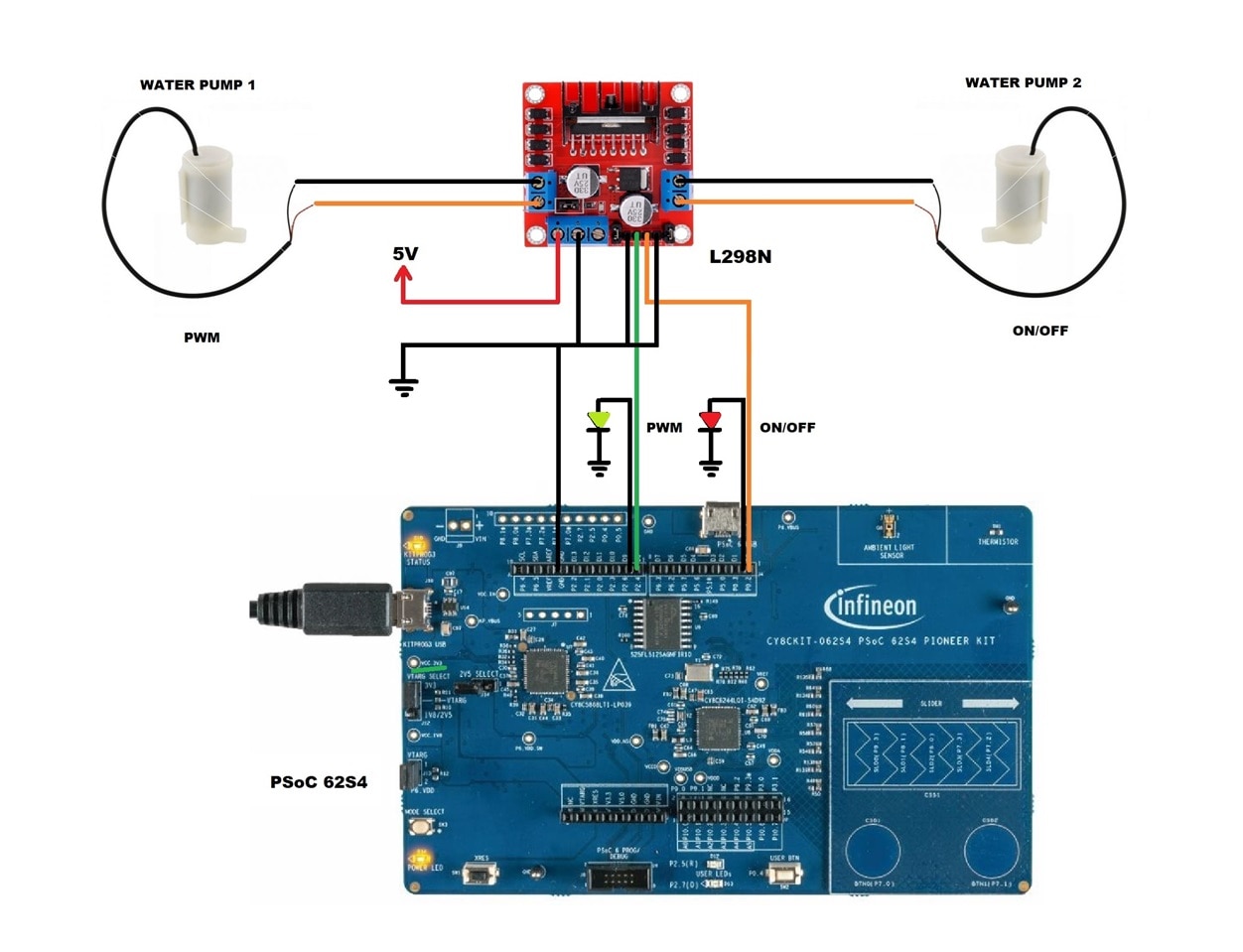

Step 10. According to the schematic diagram below, make the wiring of the PsOC 62S4 board.
The circuit wiring would look like the one shown below.
