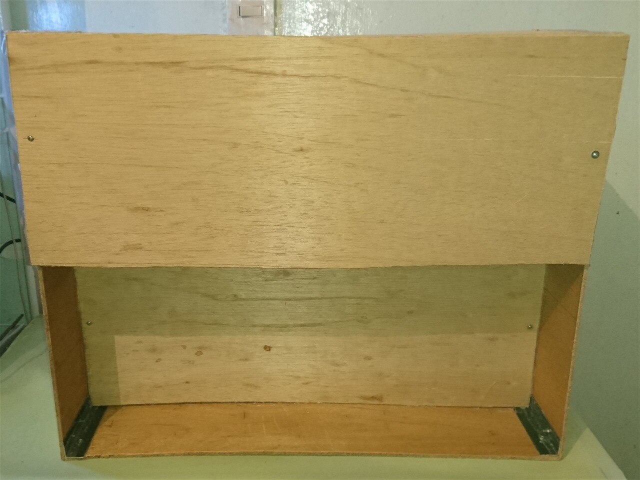

In this final chapter I am going to show you my final thoughts about this project, my experiences and what remains to be done. In the image below I show you my final project in its front view. Here you can see the basic functions of a drink dispenser that can still be improved as we will see below.
Here I show you a description of my project, goals, schematic diagram, necessary hardware and software. Below I show you the back view of my project, you can appreciate the placement of the coffee and tea drink dispensers. In my case, experience helped me to understand what type of containers I will use in the future, maybe investigate square containers to save space.
