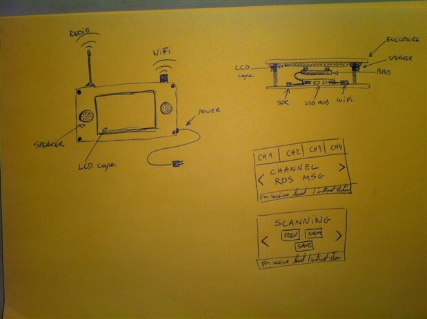

All-in-one solution
The provided case is not sufficient for the entire setup. This is why I would shoot for a “all-in-one” solution where I would create an enclosure able to contain:
  • BBB + LCD cape
  • Wifi USB stick
  • Radio antenna
  • Speakers
I’m thinking of two plexi glass panels (with cutouts for LCD and speakers) holding everything together in a good looking, but compact solution.
Early sketches of the solution in mind

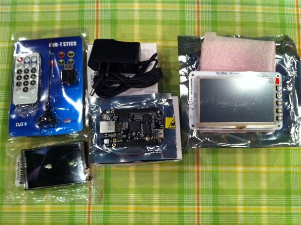

Kit
My kit arrived yesterday. It looks great!
Contents of the BBB Radio Challenge Kit
Unfortunately it's missing the Wifi USB adapter, but I've been told it should arrive any day.

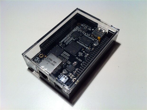

The BBB fitting nicely in its case

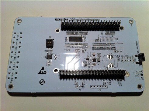

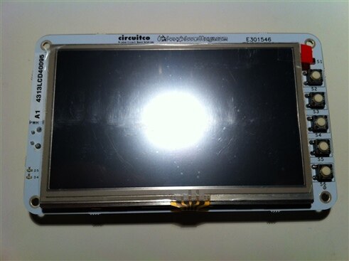

LCD cape from beagleboardtoys.com
