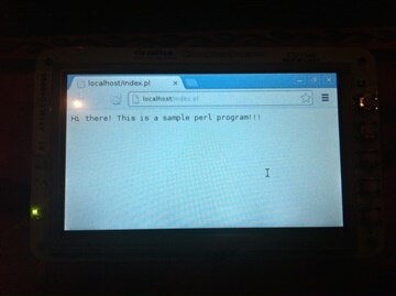

Testing a sample CGI/Perl page, I could validate the installation:

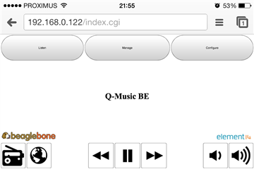

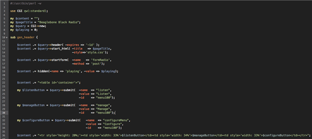

While making the interface, I tried to avoid static values as much as possible. The interface should work on more than this very specific LCD and specific resolution alone.
By defining everything in proportions, the interface should look the same (or as much as possible at least) on different devices such as pc, smartphone, tablet, and LCD cape.
The code is still unstable, so I'm only providing a small preview here. The full code will be available once the interface is stable and finished.

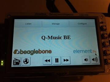

Some screenshots/pictures of the interface accessed from different devices:
On the LCD cape:
On the smartphone in landscape mode:

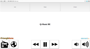

And finally, on the laptop:
