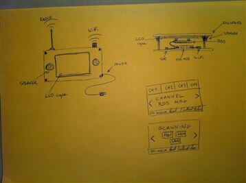

My original idea, as proposed in my Roadtest application, was to "sandwich" all of the components between two sheets op plexiglass and provide access to the LCD for control.
Because I'm not the handiest man around, I thought of designing the plexi sheets I would need and have them laser cut through some online laser cutting service.

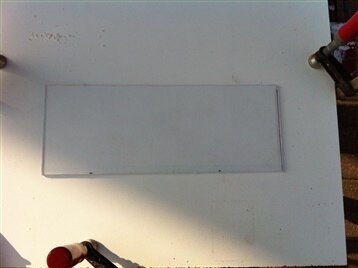

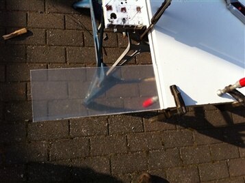

Problem #1: How do I cut a piece of the right size, from the bigger sheet ?
I found that locking the plexi between two pieces of wood, making some cuts and snapping off the piece worked best.
This was after I tried using an electric saw, manual saw, and what not ...

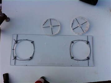

Problem #2: Cutting clean circles
From my little experiment with the electric saw earlier, I noticed that cutting too fast (and most likely with the wrong blade/drill bit/...) the plexi was melting.
I needed to cut two big circles for my speakers though, so I tried to drill slowly using a hole saw (meant for wood).
So far, so good, the hole saw did the trick. On the the third and final problem.

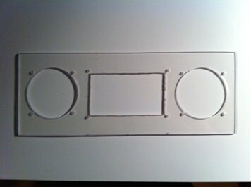

Problem #3: Cutting a clean rectangle
Moving from success to success, I was more and more afraid of messing up and having to start all over again.
The last thing I needed to do, was to cut a rectangle out of the middle for the LCD touch cape to fit in.
I used a Dremel with a cutting disc to slowly cut out the shape. The plexi was melting, but I figured I would clean the edges using sandpaper afterwards.

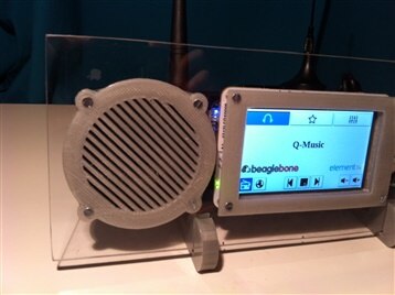

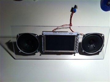

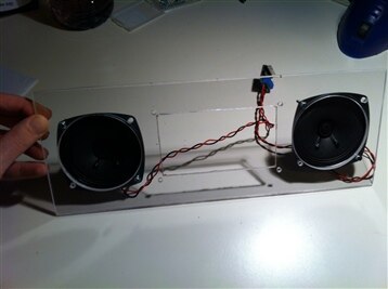

I started fitting the components to see if my work was at least usable:
The different components fitted nicely, but the cut edges were very messy. So I came up with an idea to mask all of that ...

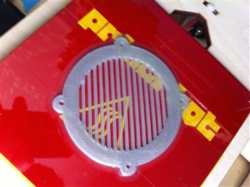

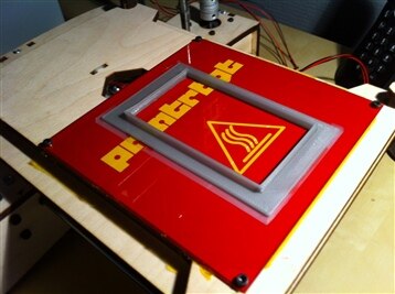

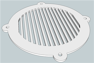

I designed and printed some custom pieces to:
  • hide my messy work
  • protect the speakers
  • hide the LCD cape buttons (as I don't use them)
  • give the overall build a nice look

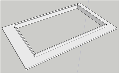

I designed the pieces in Sketchup, based on the measurements I had made to cut and drill the plexi.
After a few test prints and some corrections, I printed the final version of each piece:
  • speaker grill
  • LCD cover

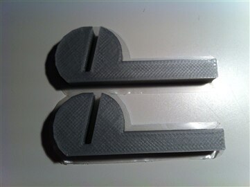

  • radio stand

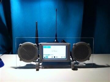

Here it is, the end result. My Beaglebone Black Radio in all of its glory:
The cables at the back still require some more cleaning up, but overall I'm very satisfied with the result!

    Nice work... from what I recall the cap should be worn backwards or an angle ... Frederick The trick to cutting most plastics is slow speed and a thin (ie not deep) blade. You can use a fairly coarse blade…
    You can use a fairly coarse blade designed for wood, as the plastic is quite soft.
    Sometimes a crosscut (where the teeth are wider than the blade) helps as the blade doesn't rub the surface.
    A variable speed jigsaw is almost a must, but failing that very short bursts and pulling the blade back from the just cut area helps.
