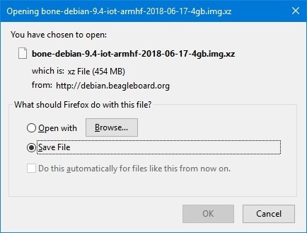

First, browse to:
https://beagleboard.org/latest-images
Then under:
Stretch IoT (without graphical desktop) for BeagleBone and PocketBeagle via microSD card
Click on: Debian 9.4 2018-06-17 4GB SD IoT
Save the file (Figure 1.)

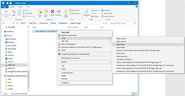

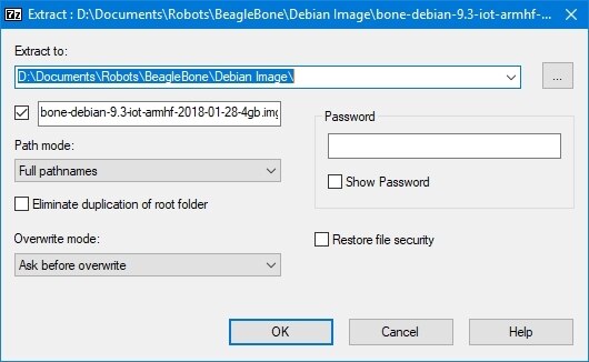

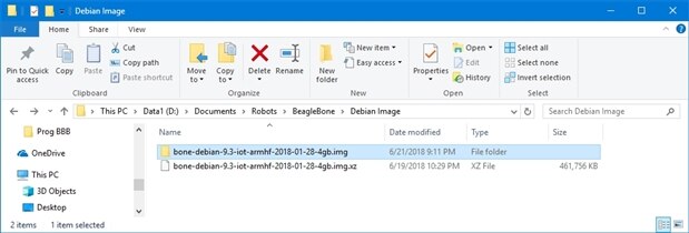

I moved the file from the Download directory to another directory incase I need it again. The image file is compressed. You need to un-compress it before loading it onto a microSD card. I used Zip-7 to un-compress my image file (Figure 2).
Click on the OK button when you see the window displayed in Figure 3.
Once the file is  uncompressed, take note of the directory that contains the image file (Figure 4).

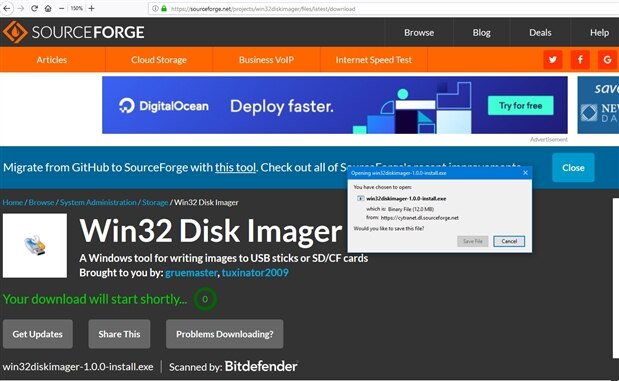

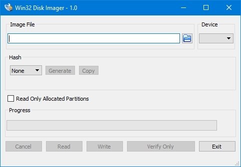

Next, download the disk manager. The disk manager is used to load an image file onto a microSD card. Browse to:
https://sourceforge.net/projects/win32diskimager/files/latest/download
Save the file (Figure 5). Again, I moved the disk manager exe out of the download directory.

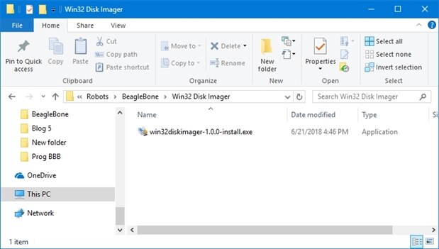

Double click on the win32diskimager-1.0.0-install exe (Figure 6).

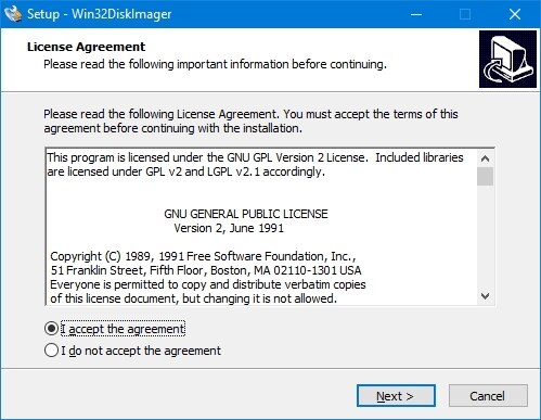

Accept the license agreement (Figure 7). And click the Next button.

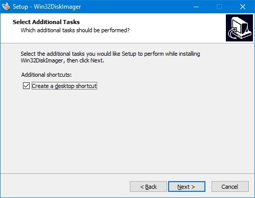

Click the Next button again (Figure 8).

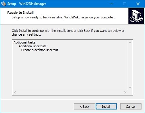

Click the Install button (Figure 9).

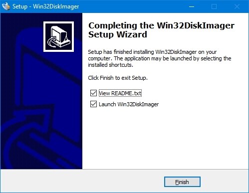

Click the Finish Button (Figure 10). The disk manager will automatically start (Figure 11).

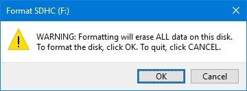

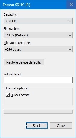

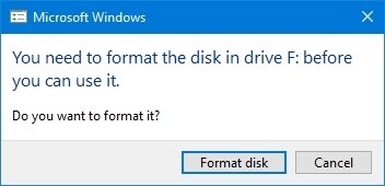

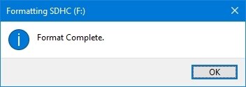

Insert a microSD card into your PC.  Click on the Format disk button when asked to format the disk (Figure 12).
Click on the Start button (Figure 13).
Click on the OK button (Figure 14).
Click on the OK button when the format is completed (Figure 15).

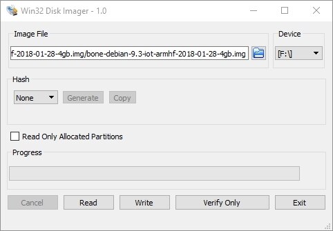

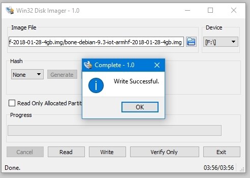

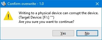

Click on the Folder Icon and browse to the directory that contains your image (Figure 16). Select your image, then Click on the Write button.
Click on the Yes button when you are asked to continue (Figure 17).
When the Write Successful pop-up window is displayed, click on the OK button (Figure 18).

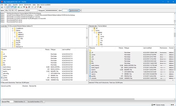

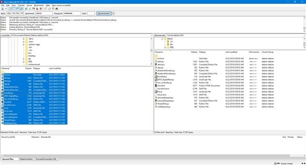

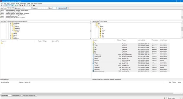

Before booting with the new image copy any files you want to save from the old image to your PC. I used FileZilla to perform the copy (Figure 19 & 20).
   Figure 19.
  Figure 20.

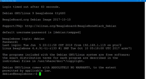

Take the microSD card out of your PC and insert it into your BeagleBone Black. Plug your BeagleBone Black into your PC and press the power button. Once the BeagleBone Black is powered up logon onto the BeagleBone Black (Figure 21).

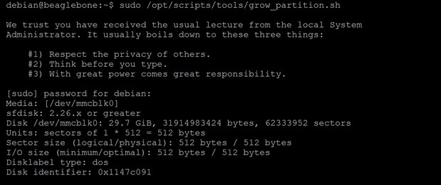

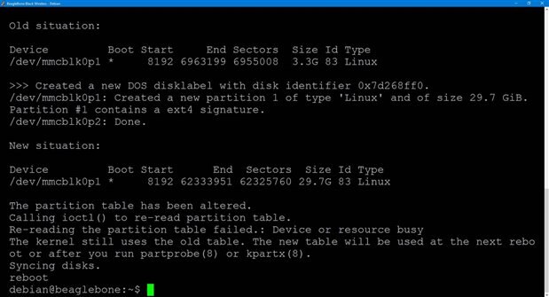

The first thing you want to do is expand the filesystem. Fortunately, Robert Nelson created a script for that. Run “sudo /opt/scripts/tools/grow_partition.sh” (Figure 22 & 23).
You need to re-boot for the expansion to take effect. Press the Reset button on the BeagleBone Black. Once the BeagleBone black has booted, logon.

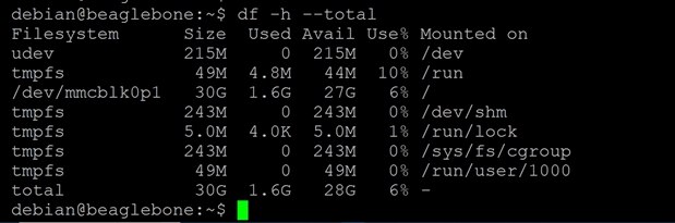

Run “df -h –total” (Figure 24). Note that the filesystem has expanded. I used a 32G microSD card, so I have 27G of free space in the filesystem:
/dev/mmcblk0p1   30G 1.6G   27G   6% /

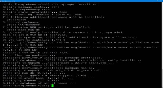

I noticed that the Debian image I loaded did not have the man pages. Therefore, the first thing I did was installed them:
Run: “sudo apt-get install man” (Figure 25).

This would be a good time to copy your application files to the new image. Again, I used Filezilla to perform the copy (Figure 26).

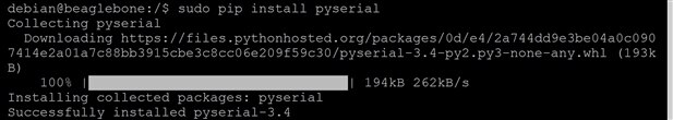

I did not receive any out of sync errors, so I did not have to install a newer version of Nodejs. However, I had to install pyserial.
To install pyserial run: “sudo pip install pyserial” (Figure 27).

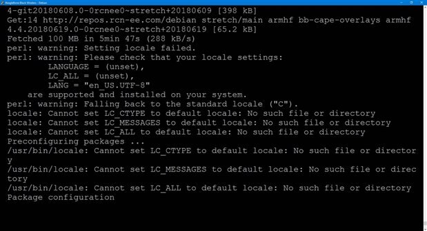

Figure 29 is an example of an error caused by losing your locale settings. Lack of locale settings can cause package installations to fail, not to mention deny access to Cloud9. It is simple to fix. Just run “sudo locale-gen” (Figure 30).

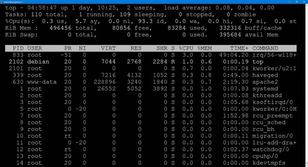

Memory/CPU usage
Here is another useful command. It helps determine why your system is running slow. It displays the processes that are currently using the most resources on your system. The display is updated in real time. Run “top” (Figure 31). To exit top press ctrl-C.
