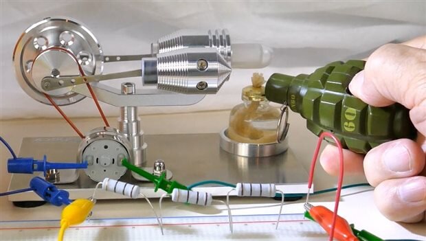

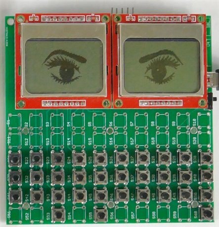

This roller coaster project had some ambitious goals because it is always fun to try and stretch to see if you can achieve them. Dealing with 7 MCUs and all the different development environments wasn't too difficult, but it was still lots of work. Designing the PCBs was fun and they worked well. However assembling 5 PCBs was a bit of a chore because they had hundreds of switches to mount. I definitely did not properly anticipate the time required to design 66 different 3D printed parts and printing hundreds of 2 tone keycaps is also pretty tricky.
The major achievements of the project were:

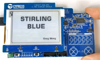

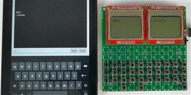

  • Design, build and program a PSoC4 based Bluetooth terminal with dual LCDs and 60 button keyboard - demonstrate communicating with an android tablet via Bluetooth

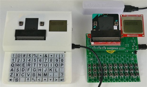

  • Design, build and program 2 wireless Type-N-Text micro:bit systems also with LCD and QWERTY keyboard - demonstrate TNT-to-TNT wireless communications
  • Getting a PSoC4 to communicate with a micro:bit via SPI
  • Design a complete package for the Type-N-Text device (66 different plastic parts for each device)
  • Designing and printing 2 types of PCB and assembling 5 PCBs

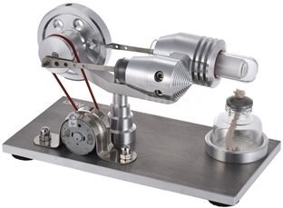

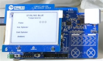

  • Research Stirling engines, how they work, acquire an engine and measure temperatures, speed. output voltage and output current.
  • Developed a method of measuring fuel level using capacitance

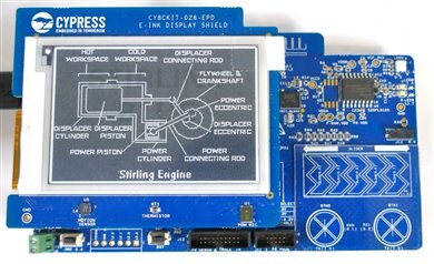

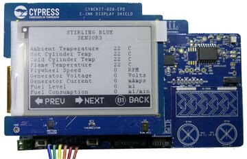

  • Learn about the PSoC6 and make some working programs towards monitoring a Stirling engine

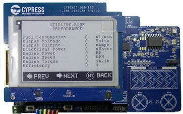

  • Automated monitoring of the Stirling engine
  • publishing engine data via Bluetooth
